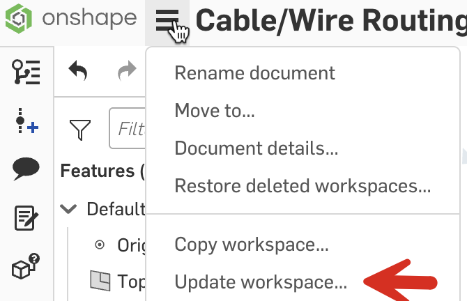

    Any new docs will always be at the correct version, and the last update was 3 weeks ago, so unless you've had the docs open constantly that should not happen. Try the "Show code" trick to see if the library versions are indeed mismatched. On rare occasions docs cannot be upgraded and a support ticket is the best option.
    You can also try this:
