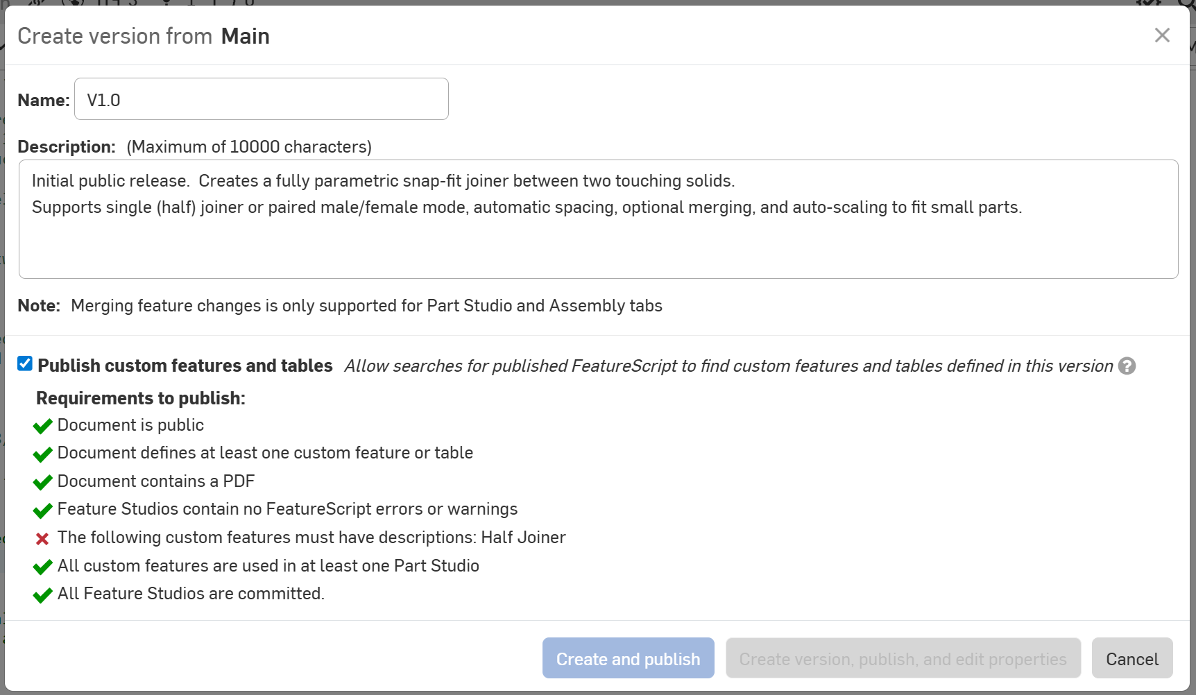

    I'm creating custom tables in my Wires feature and Freeform Spline feature, which gives a warning I've been ignoring about it impacting performance, because I like that the table is just there for anyone using the feature (am I right to think that people would need to also add the table otherwise?). I can't publish those features since this is flagged as an error. Thoughts on the best solution? Should I just move the tables to another Feature Studio?
    I'm also finding the pdf requirement a hinderance for some I've made. I know the real solution is to make a pdf, but my time is constrained such that I probably won't get to that, and I'd like to publish them anyway. I understand that the pdf requirement is meant to act as a filter for quality and completeness though, so maybe I'm just proving that it's working.
  • ilya_baranilya_baran Onshape Employees, Developers, HDM Posts: 1,255 image
    @Evan_Reese
    On the geometry.fs warning, the thing to do is to remove the geometry.fs import and replace it with imports of specific modules actually needed.  For example, in freeform spline, you just need
    export import(path : "onshape/std/blendcontroltype.gen.fs", version : "1746.0");
    and that way you can keep the feature and table in the same part studio.
    On the pdf requirement, the perfect is the enemy of the good -- at minimum just have some text explaining what the purpose of the feature is and any caveats -- it doesn't have to be pretty.

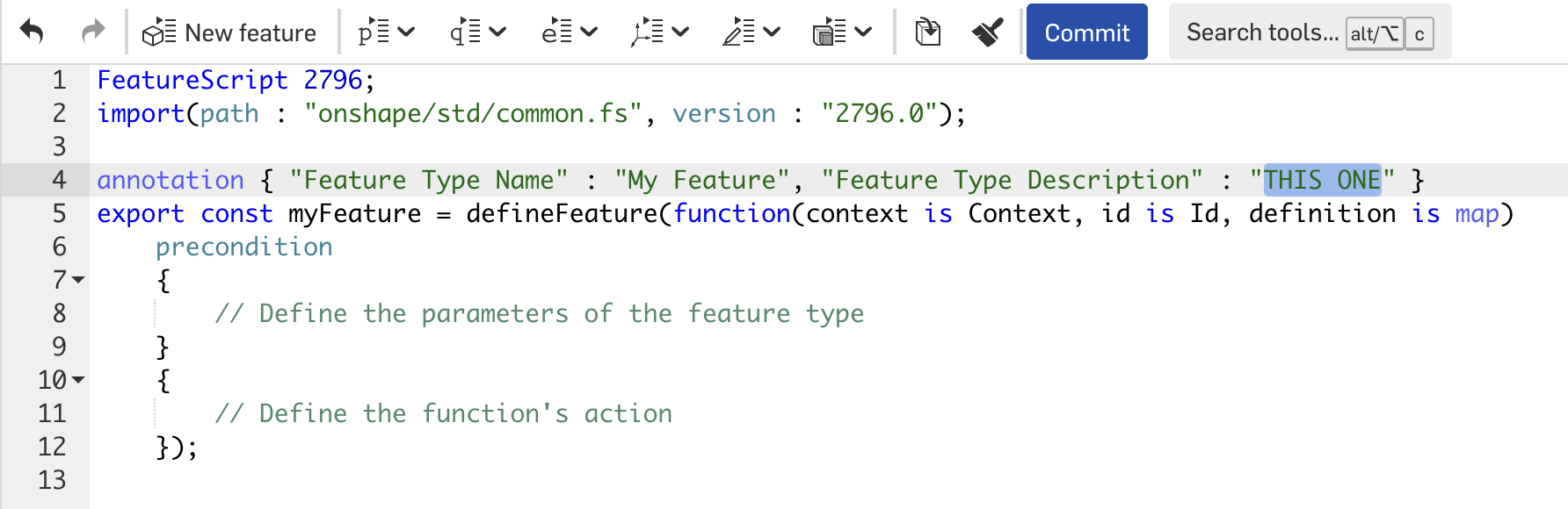

    In general, it took me too long to 1) find the template and 2) find out where to set the `Feature Type Description` (see below screenshot for where I ultimately had to stick it in order to publish).
    I applaud the pursuit of high quality entires, and I think this is the right approach. That being said, please, please, please don't just give me a failure message when I try to publish, make sure that there is a useful link to how to resolve the problem! Having high quality publishing instructions will result in high quality outputs. Esp. re the PDF, where making it easy to find the suggested template will result in lots of us using it.

    Hi all. Can anyone please let me know what this error message means and how to resolve? I have added descriptions in six specific different locations and non have worked. Thank you.
    I think it's the feature description itself here
