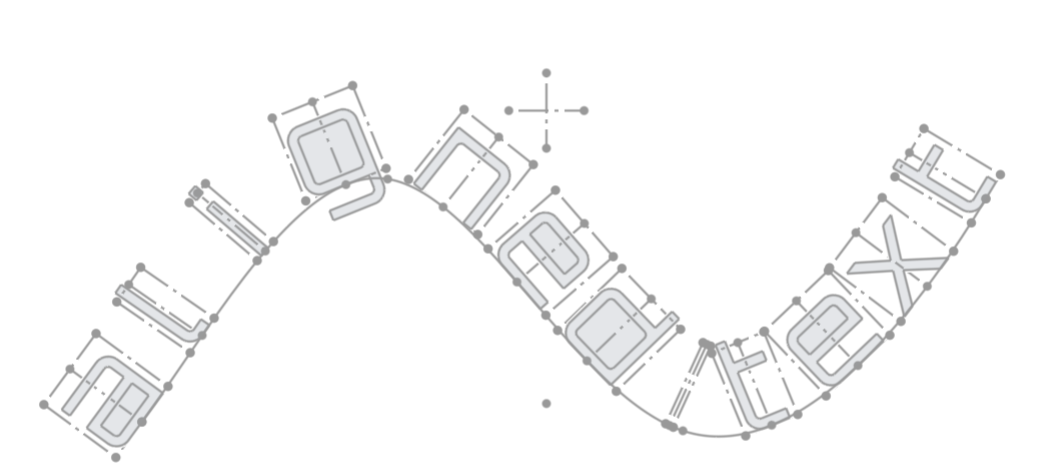

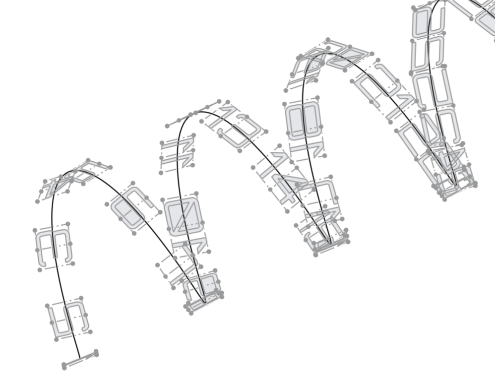

  • jnewthjnewth Member, OS Professional Posts: 112 PRO
    @PMEcology Not quite sure what you need. I wrote a text placement feature that creates sketches or solids. Here's a set of numbers arranged on a spiral:
    Or like this:
    Kinda depends on what you're trying to accomplish. You can read about it here: https://forum.onshape.com/discussion/comment/101768
    and find it here: https://cad.onshape.com/documents/4e187c2b2f7f4974f4e2b612/v/4446c75baffebee73f367acc/e/cdef2b8905cd0f5f8947fafc
    That document contains a large number of examples to show you how different parts work.
