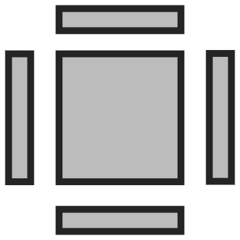

Description:
This custom feature offsets the faces
adjacent to the face you select.
Prerequisites:
A solid body with more than one face.
Notes:
  1. Select a face.
  2. Choose the offset thickness.
Application:
This feature is most useful when you need to edgeband an entire wall of various panels.

    hey, cool idea! I can see this being super handy for you after seeing the gnarly cabinet setup you posted. To me, it might make more sense being called "Move adjacent faces" since it's really more similar to the move face command, right? I'll add it to my toolbar.
  • EvanReese
    EvanReese Member, Mentor Posts: 3,095 PRO
    oh, and you know how much I appreciate that it already has an icon :smiley:
