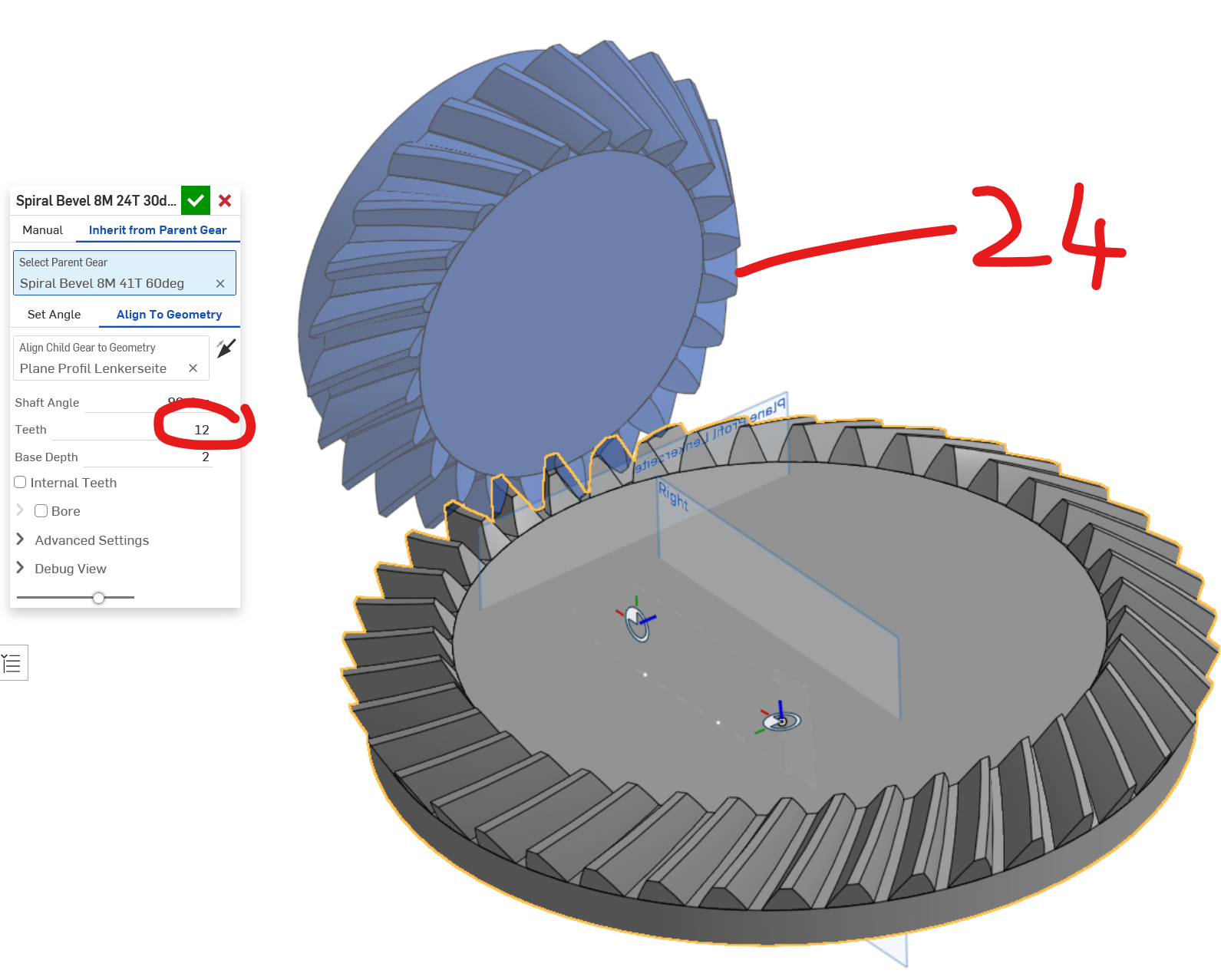

    ehsan_moravvejiehsan_moravveji Member Posts: 8
    I tried to inherit from parent gear in order to create my second compatible gear hoping to get a ratio other than 1:1 (because I need to reduce RPM and increase torque with my gears). However, the second/inherited gear keeps the size of the first gear. I was expecting to be able to set a different "module" value for the second gear leading eventually to a different radius/ratio. But, an inherited gear does not have such a parameter. Playing with other parameters also did not help further. I am sure I am still missing a nitty gritty detail from the gear lab menu.
  • Options
    eric_pestyeric_pesty Member Posts: 1,521 PRO
    edited March 26
    At first I thought there was a bug as setting the number of teeth in the "child" gear didn't have any effect...
    But then realized that it's the bevel angle that is going to set the ratio: 45 deg requires two identical gears, try setting the parent gear to something else (like 30deg) and you will see the number of teeth adjust accordingly (an error message would be helpful here).
    A good tip is that you can edit the first gear feature with the "final" button enabled to see how the changes to the first one affects the second.
    That said I'm really not an expert on gears so you might want to do some reading on how all of this works if you want to get predictable results. I'm sure there's a formula you can use to figure out the exact bevel angle for the ratio you want (rather than trial and error) but I don't know it off the top of my head.
    Thanks @eric_pesty for the tips. I could get my coupled gears to working.
