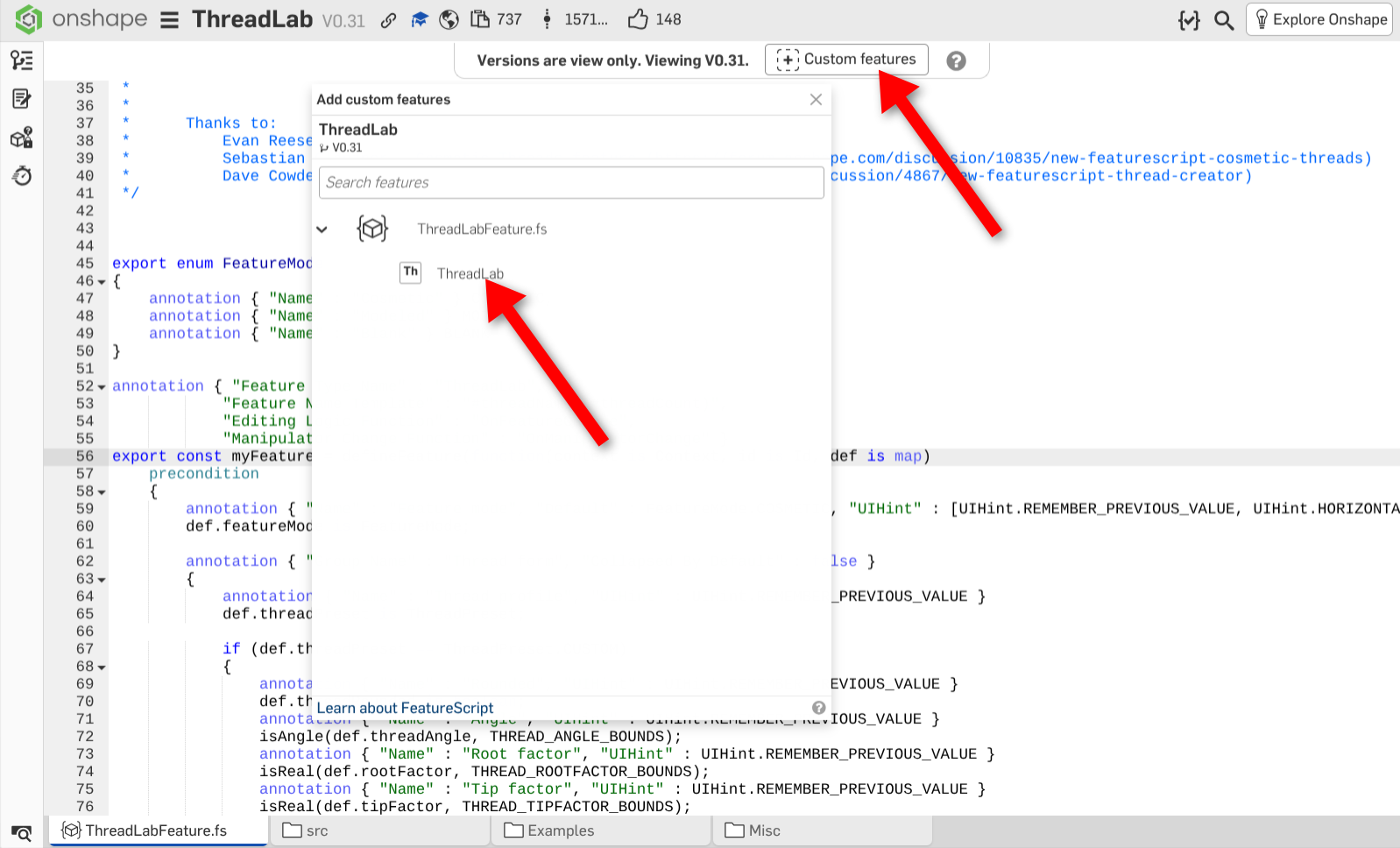

    If you want an actual detailed thread model, I would recommend the "threadlabs" custom feature: feature: https://cad.onshape.com/documents/5c0528b62c1fbb13a2a0e739/v/0bb9d00523f327052c0a2e24/e/7cbb452d4d5e963a034ce616?jumpToIndex=2687
