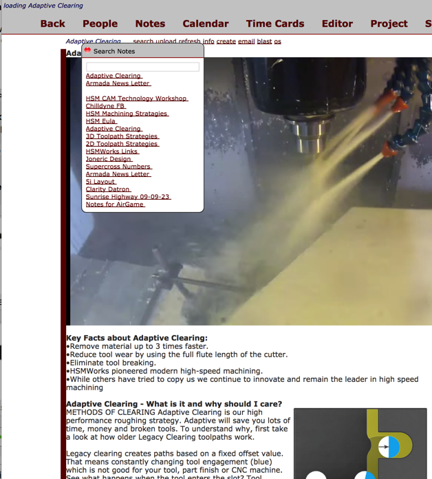

    Search for Onshape Document Assets Try This

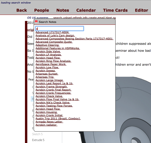

    1 character
    1 character loads everything beginning with that character. I'm searching description.
    2 characters
    2 characters loads everything beginning with those characters.

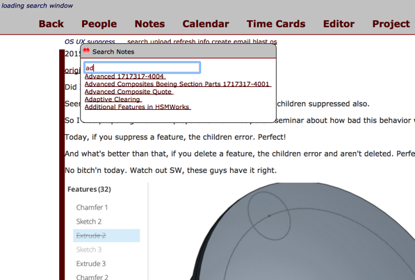

    3 characters
    3 changes the search. Now, it looks at the entire string. Also, I search both the description and the body fields and separate the results with a linefeed.

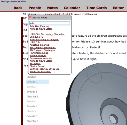

    pick
    When you pick, it loads the note. I keep all my engineering notes on the cloud, and have been for the last 9 years. Even though I've had 7 computers and hundreds of customers over the years. I can still find the engineering notes even though I barely remember creating the notes. I love the cloud.

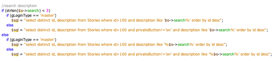

    code
    It's pretty easy, look at the search string size and branch to different queries. Please don't hack my website.
