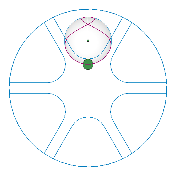

  • Drag large green circle on ‘Geneva 2022_Driver.SLDPRT’ either clockwise or counterclockwise.
  • Assembly animates in real time.

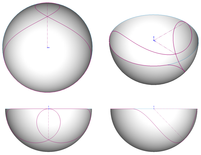

The technique makes use of a hemispherical shaped Spline in a 3D Sketch within ‘Geneva 2022_Path.SLDPRT’. The 3D Sketch forms a continuous loop allowing for an infinite number of rotations. The Driver part is mated to the Path part. The Path part is mated to ‘Geneva 2022_Wheel.SLDPRT’ via a Gear Mate with a 6:1 ratio. This technique has the potential to work in other mechanisms where intermittent motion is required.

Spline Path General Layout:
  • NeilCookeNeilCooke Moderator, Onshape Employees Posts: 5,987 image
    Great idea but there is no path mate in Onshape and there would be too many solutions for the tangent mate to work. You also don't need SW22 you can just import it into Onshape as is.
  • martin_kopplowmartin_kopplow Member Posts: 1,297 PRO
    Clever approach! What if the driver was a point defined 0 to 100% length on the 3D spline (or some other spline or line)?
