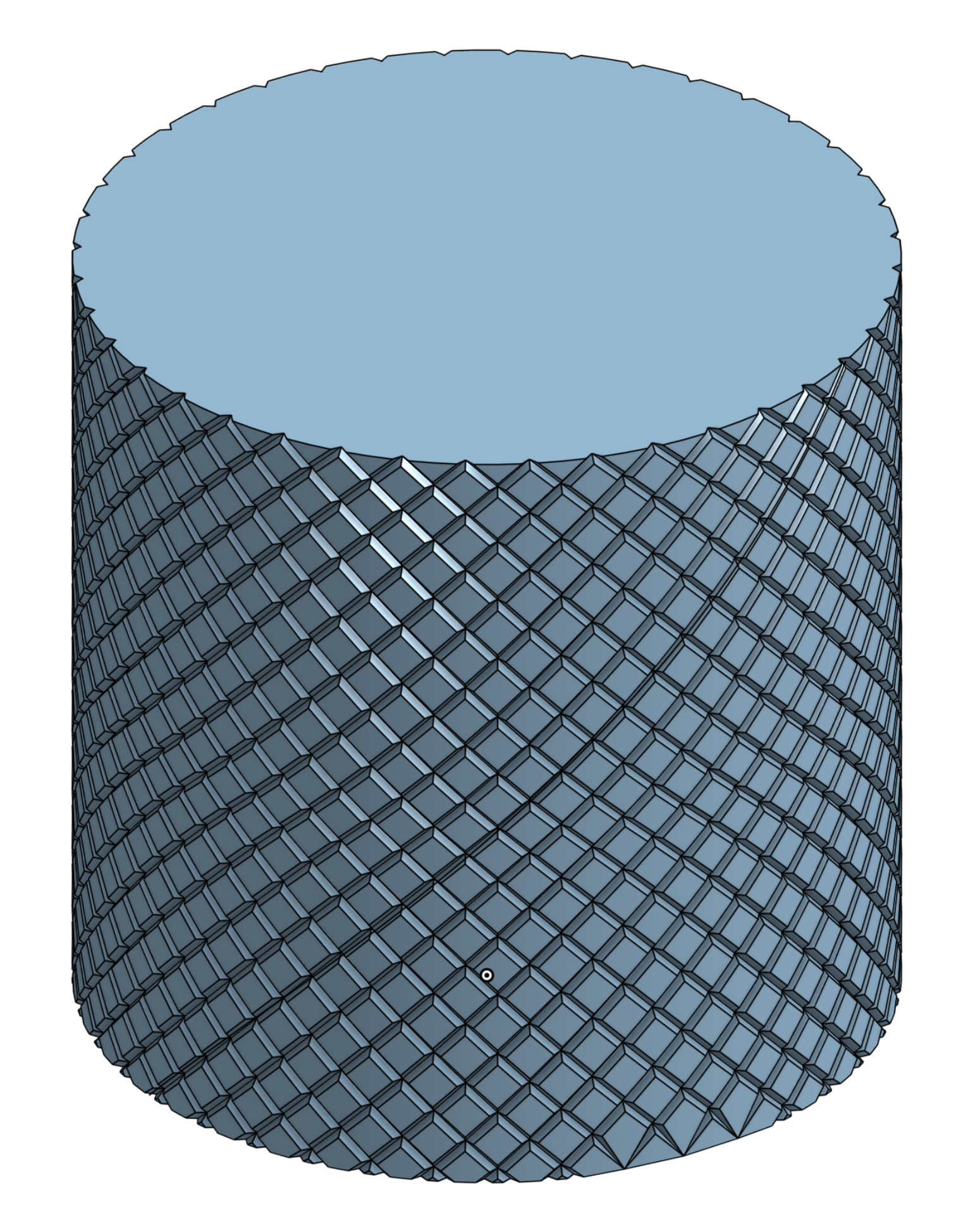

HI All
Did anyone manage to make a Knurl work? I'm trying to find the best way.
My normal method (solidworks) would be to do the following
  1. Draw Helix on the surface to be Knurled
  2. Sketch a triangle at end of Helix
  3. Sweep a cut with the sketch along the Helix
  4. Circular pattern the the sweep
  5. Mirror the circular pattern
With Onshape I finally managed to get the following to work
  1. Draw Helix on surface Clockwise
  2. Draw Helix on surface Anti-Clockwise
  3. Sketch Triangle at end of helix
  4. Sweep a New part on first Helix
  5. Sweep a New part on second Helix
  6. Circular pattern both of the new parts
  7. Boolean Add all of the sweeps together
  8. Boolean Subtract Sweep mesh from part I want to Knurl
It works but is a bit long winded mainly because you can't pattern or mirror the feature you have to do the faces, but faces patterning does not work when the resultant geometry intersects.
Anyone any thoughts on how to do this more efficiently?
Screenshot of my end result attached

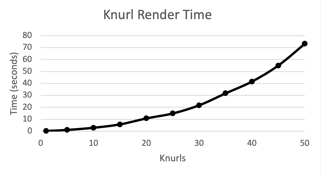

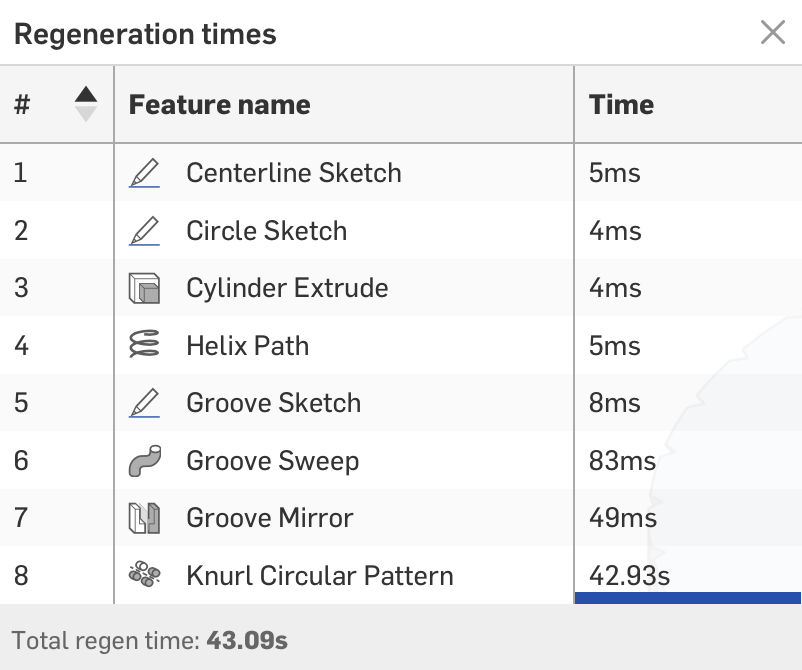

    First time poster looking for advice on how to speed up my regeneration time for adding knurls to parts. I used what I believe to be the same approach described above (create a helical path along the outside of the cylinder, carve out a small groove along the path of the helix, mirror that feature, and finally repeat the feature/mirror multiple times around the circumference of the cylinder). The model I created is shown below with 40 knurls:
    The issue I'm having is the regeneration time goes up exponentially with the number of knurls added to the cylinder using the circular feature pattern in OnShape (last step in the model). The YouTube examples I've watched (e.g., https://www.youtube.com/shorts/uG8eD1qUcNU) don't appear to have any appreciable lag but I am experiencing regeneration times of almost a minute for a simple 40 repetitions of the knurl pattern and OnShape completely stalls on my system for anything much larger. I suppose it is reasonable to expect the render time to scale exponentially with number of repetitions of the knurl feature since a doubling of knurls creates 4x more intersections, but I don't understand why it takes so long on my system compared to what I see online and becomes virtually unusable after a seemingly reasonable number of repetitions.
    Here are the regeneration times I'm seeing for 40 knurls:
    And here is a plot I created showing render time as a function of number of knurls (I couldn't get anything much larger than 50 to work):
    Once it renders properly, I can manipulate the view with ease no matter how many knurls I have so I don't think it has anything to do with my CPU/GPU. I'm on a Mac Studio (Apple M2 Max, 64 GB memory) running macOS Sonoma in normal power mode and I run OnShape on Safari with JavaScript and WebGL enabled. My internet is fast with 360 Mbps download/320 Mbps upload and 20 ms latency.
    This is a recent thread on the topic but I don't see much information on regeneration times so I can't tell if this is a me problem or a common issue.
    Is there something about this model that is inherently difficult for OnShape to handle? Is there a setting I should check on my system or in my OnShape account to improve the regeneration time? Is there a more efficient way to get a knurled surface pattern on a part in OnShape?
    Thank you in advance for your feedback/suggestions.
