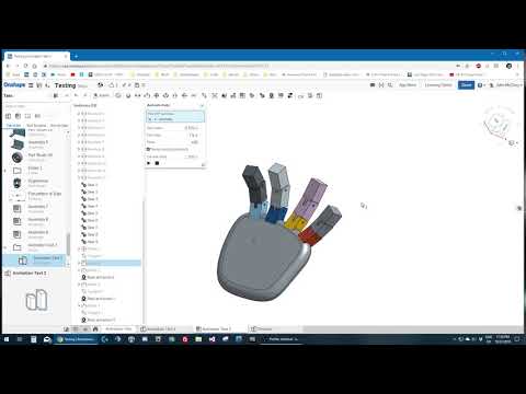

Awesome!!!
If you want the animation to look really good, you can right-click on the mate and select animate.
I chose 1080 for the end value and 3000 for the steps.
Then I clicked play, waited a while, then just watched.
It looks even better with perspective turned on, and in shaded without edges mode.
