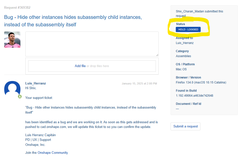

  • Shiv_Charan_MadanShiv_Charan_Madan Member Posts: 7 PRO
    https://onshape.zendesk.com/hc/en-us/requests/369382
    I have already raised this ticket. @Kevin_Gallichan
    I don't understand what is meant by status: HOLD-LOGGED.
