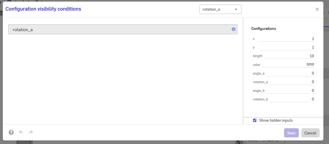

    First time needing visibility conditions since the updates:
    Am I missing something obvious? I'm trying to do a simple "Only show rotation_a" if "angle_a" is not 0 deg.
