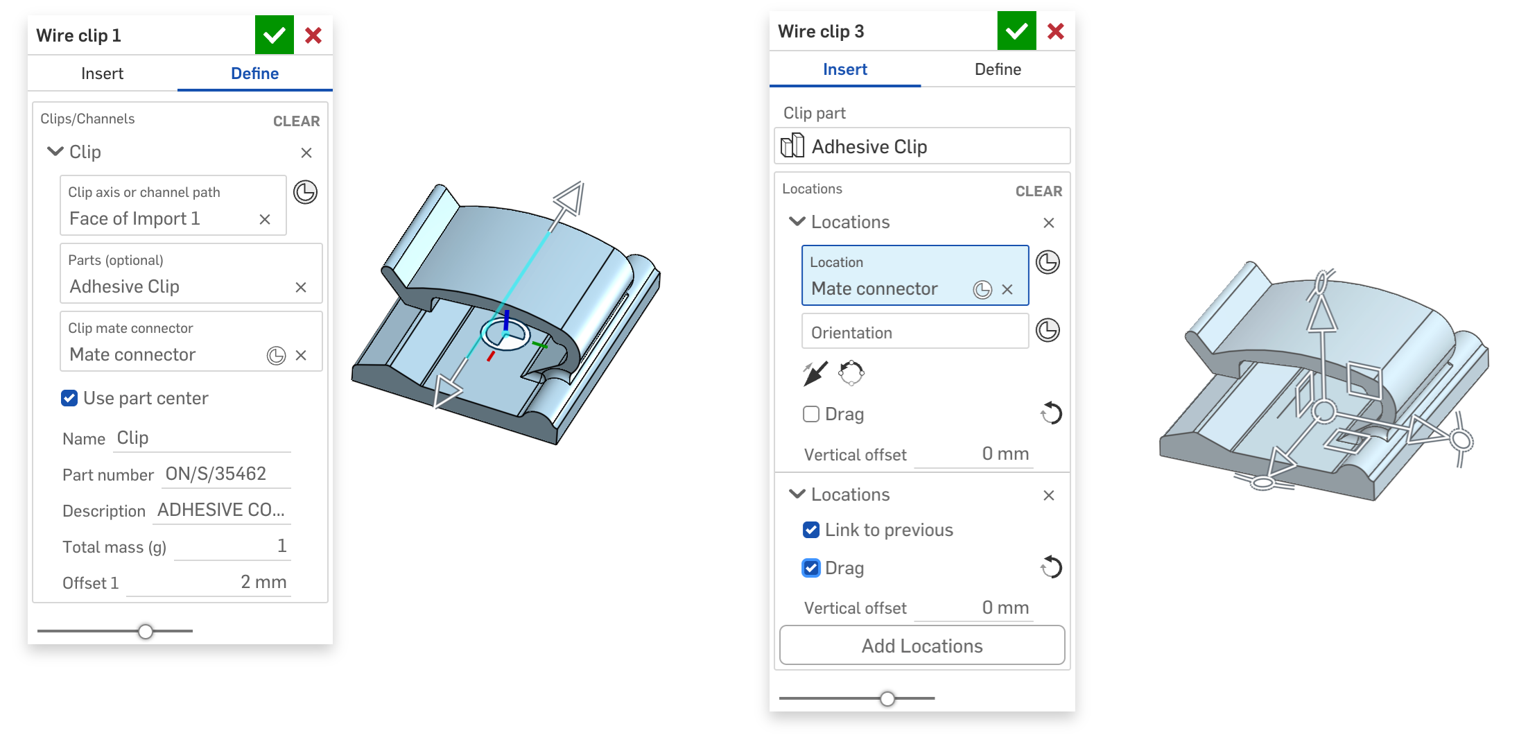

  • NeilCookeNeilCooke Moderator, Onshape Employees Posts: 5,896
    Changelog for release 1.204.2
    ⭐️ Clips now have the same metadata and positioning features as Connectors
