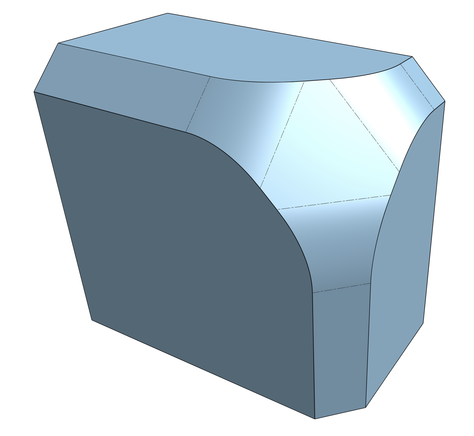

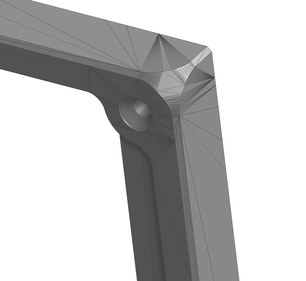

Hey guys i need some help how to make that chamber/fillet thing on the part?
GregBrown
Member, Onshape Employees, csevp, pcbaevp Posts: 379
looks like you need to
Chamferthe three edges, thenMove face, thenFillet?Or you could go crazy with some nice bridging curves and other surfacing techniques… ;)

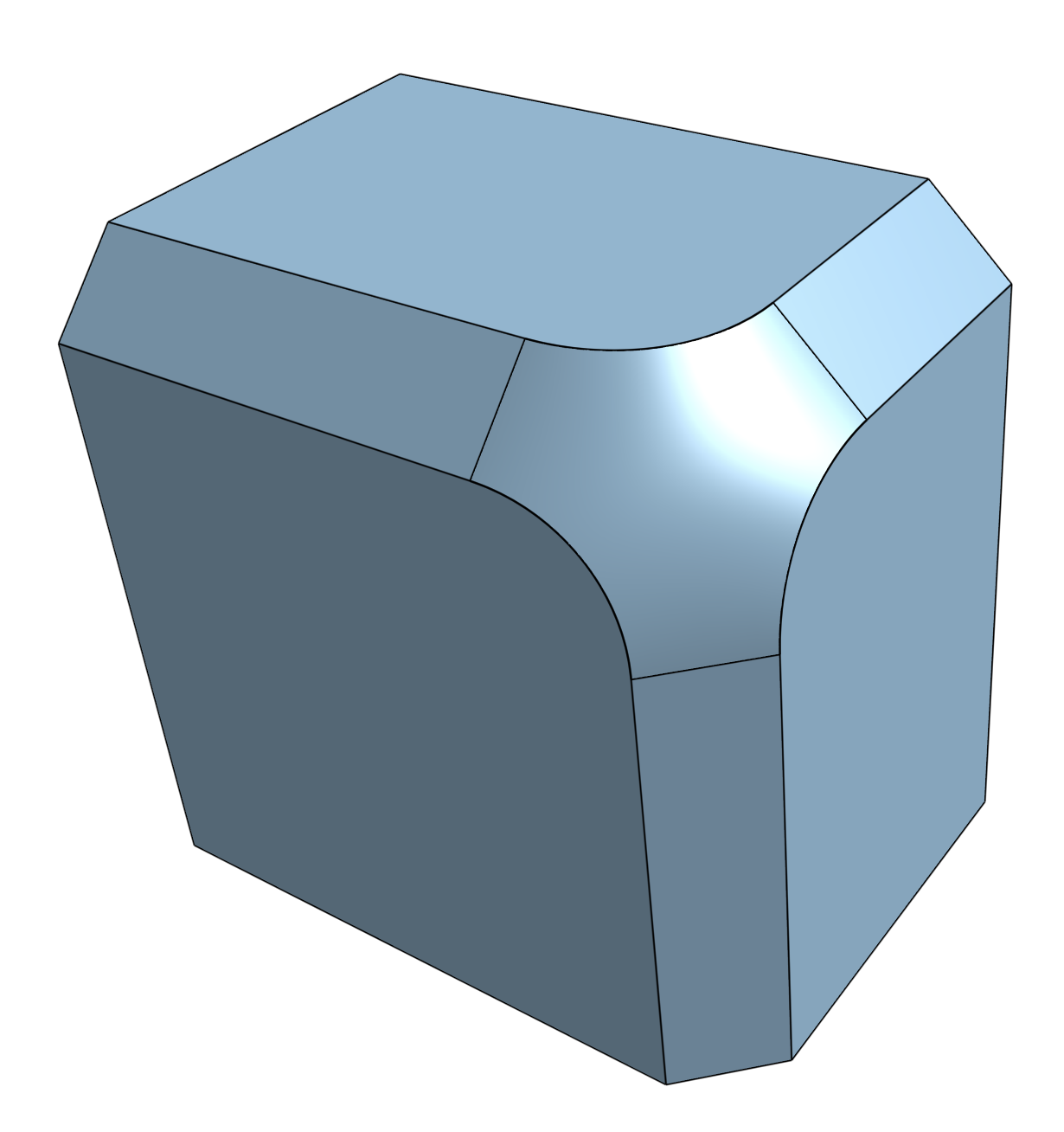

First I want to thank you for the reply on the post. I really like the second one. How do I achieve something like that? Do you mind share something like a tutorial or do you have any link where I can check?
Can you show me how you did that in the second image? I would appreciate it!
All three curves in the model are actually but intersections of the three cube sides with the same sphere.
https://cad.onshape.com/documents/26761bb9a612b23ab2d2ad96/w/082b8b168cfa9c4e97dee996/e/caefd62bcecd8664de159257?renderMode=0&uiState=6914a13274adbddaf28cfdc2
Once you know that, you could make it much easier, though. ;0)
Just sketch 3 identical radius tangent arcs, one on each side, then split the sides with them. Delete unwanted faces, use the fill tool.
