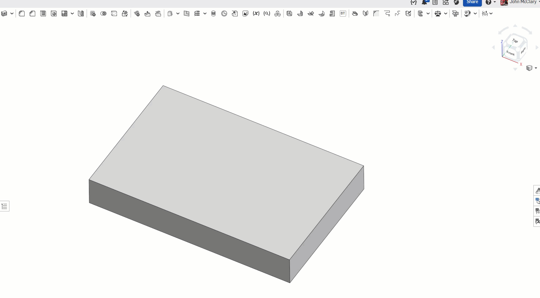

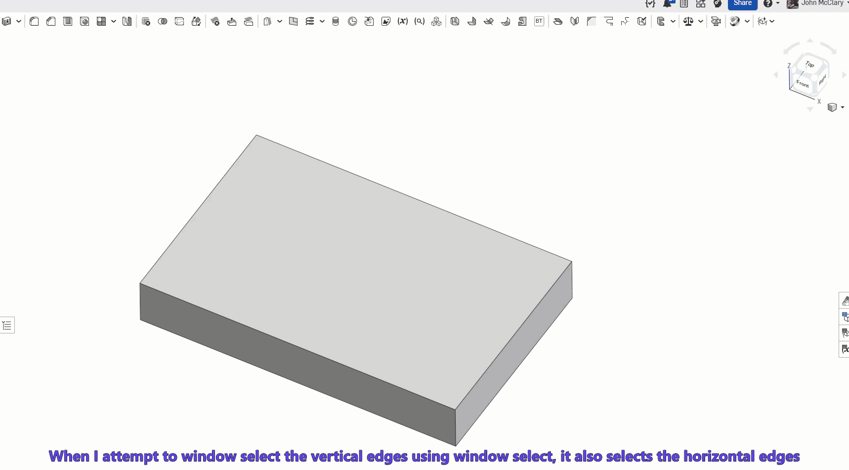

  • john_mcclaryjohn_mcclary Member, Developers Posts: 4,001 PRO
    edited December 3
    There is an issue with window selecting too. I submitted a ticket #399958
    When the edge pixel size is changed, it will sometimes select additional edges.
    The first half of the gif is with 0.6px the long edges are being selected even with the blue window select. Changing the line size back to default in the second half of the gif restores the expected behavior for a blue window select.
    So, if anyone is having selection issues, try resetting your graphics preferences until they get this fixed
  • MDesignMDesign Member Posts: 1,265 PRO
    good catch. looks like 1.1px and above seem to function ok. 1 and below I seem to get some unwanted selections. Is it also normal for onshape to select edges (or other geometry) that are hidden from view by other geometry when using window selections? I'd expect that on transparent views but not shaded ones. Or am I thinking of a different software?
    Yes, Onshape will select objects within the selection window even if they are behind other surfaces. (Think acad wire frames)
    the ~ key will allow you to cycle through those items under your pointer also.
    SolidWorks would ignore the faces of transparent parts unless you hold shift. Onshape does not do that if color of the part is transparent (the alpha value of the part), but you do have the option to select through transparency when in the "isolate" or "make transparent" modes via a checkbox. SolidWorks has this option globally in the settings somewhere.
