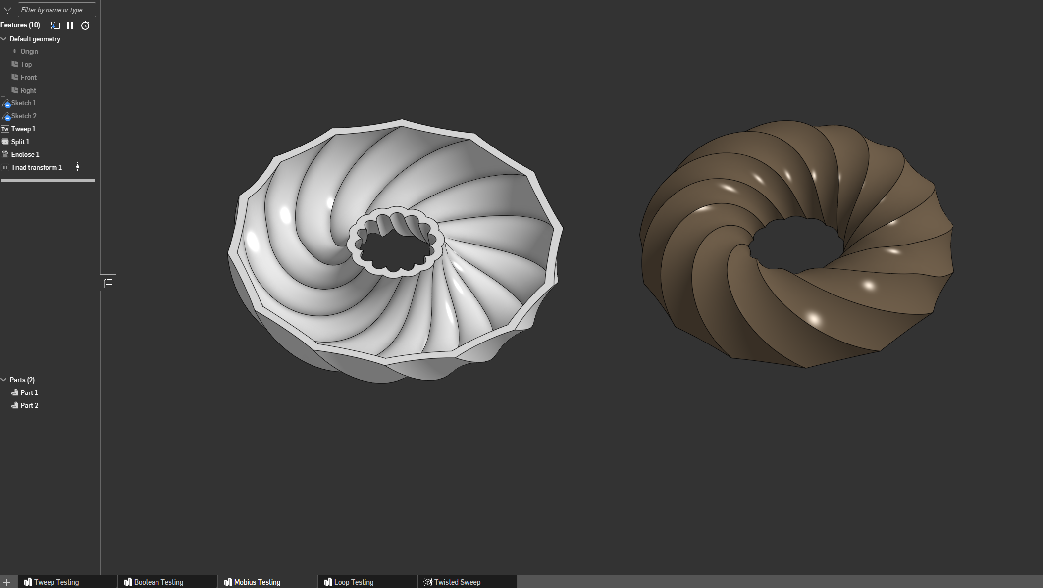

-Link to feature up front-
Look, standard sweeps are boring. They have no drama. They have no torque. They just follow the path like a good little obedient feature.
I got tired of it. So I made Tweep.
It’s a Sweep. It Twists. It’s Tweep.
Do you want your geometry to look like a churro that gave up on life? Do you need a wire that is fundamentally confused about its direction? Get it twisted.
Demo below. Merry Christmas.
Borrowed elements from @Konst_Sh 's spline expansion package which I expanded further for more flavors of 3d spiral control.

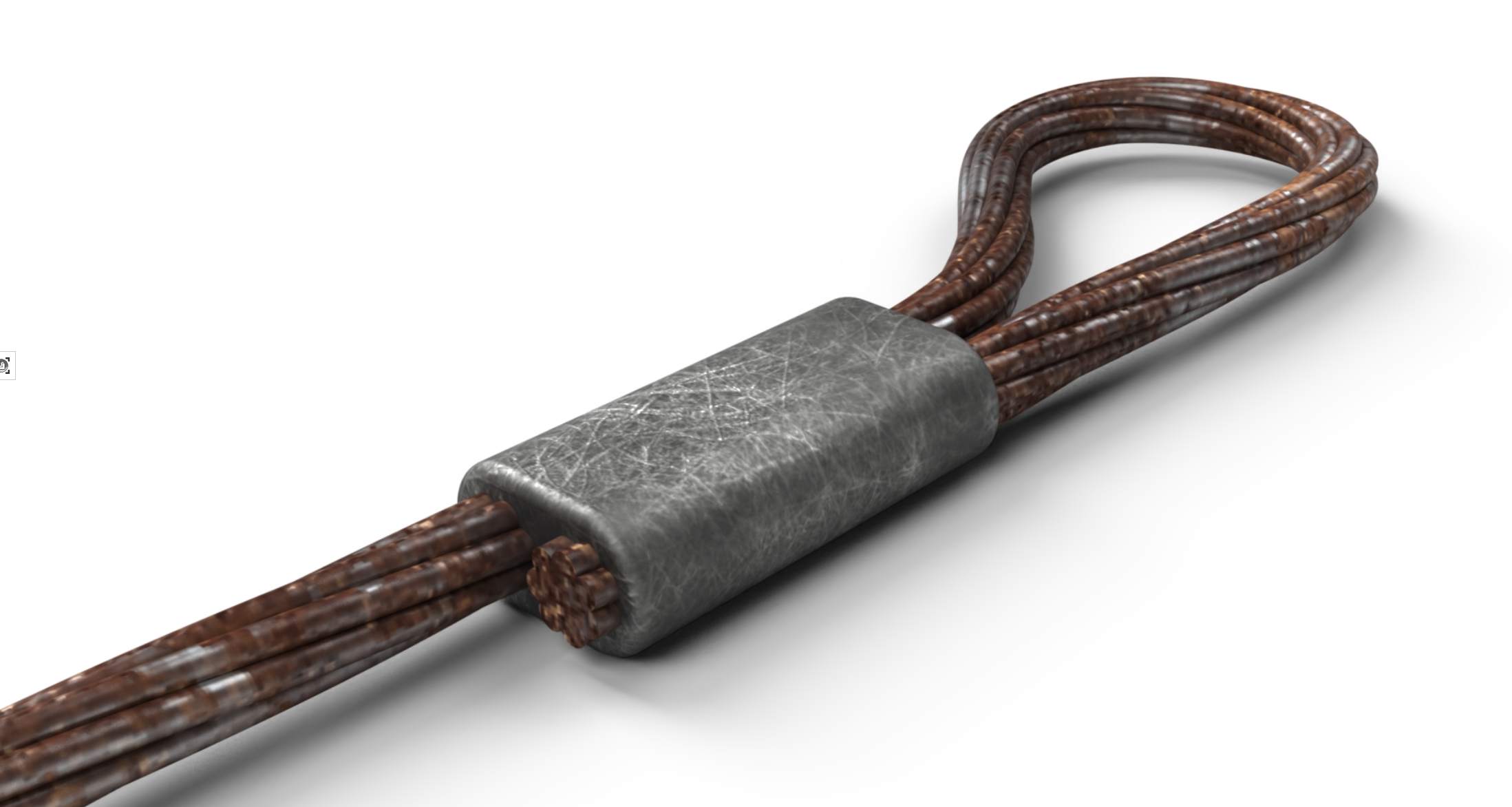

  • martin_kopplowmartin_kopplow Member Posts: 1,078 PRO
    … and I knew I could use this as soon as I saw it:
  • Derek_Van_Allen_BDDerek_Van_Allen_BD Member Posts: 446 PRO
    One of my coworkers was attempting to do some twisted wire for a standard part the other month without this feature and couldn't quite manage with the eyelet part. It wasn't for a render so I told him not to bother because it's a waste of performance but now that this exists I know the second I'm not watching he's gonna be tweeping in the standard parts library.

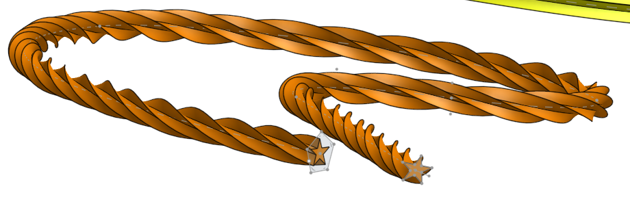

  • vanowmvanowm Member Posts: 114 ✭✭
    edited December 15
    Thank you for this, finally could get my twisted rope effect
    Two things to note:
    1. The add/remove/intersect doesn't seem to work, since they don't offer to select what parts to apply it to. (have to use separate boolean)
    2. It doesn't seem to work on closed paths (splitting the path in half and using two tweeps in opposite direction works fine)
    @vanowm I've gotten it to work on a couple of closed path cases. Do you have an example to share where it fails? I'm suspecting something mobius loopy might be a problem.

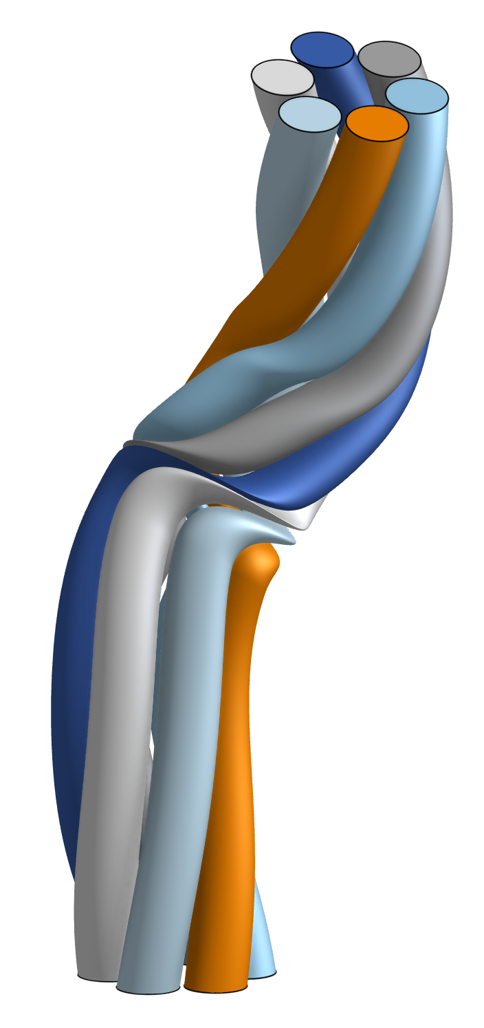

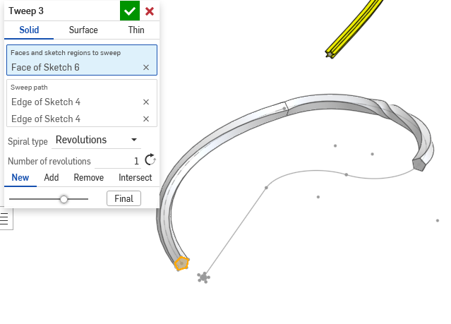

  • MDesignMDesign Member Posts: 1,265 PRO
    Am I doing it wrong? I tried doing a star on a spline. That was a big no no. So I tried just a pentagon. Shouldn't tweep at a min be able to do what sweep does at a basic level? Essentially make sweep obsolete? Or was that not your intention? In the example in the pic. on the right… The total rotation is correct, but its not even throughout the sweep. It also won't let me add the remaining segments to the path. If I try going less than .65 revs it doesn't like it either.
    Link me the part studio and I can try diagnosing. I admit I published quick just to get the feature in some hands with less than perfect testing but that was partly on purpose to get more cases I wouldn't think to try out.
    @MDesign for now try doing a composite curve of the sweep path and approximate it. The way this feature works under the hood is it draws a single curve spiral for the twist and lofts that back to the original input curve. Then it's just a face locked sweep. If the number of segments between lofts are a mismatch things get real wonky and I still need to go back and apply the evDistance auto loft from the other thread @ry_gb and I were working on to smooth out this behavior. Approximating the path will make things smooth and let your tweep go through.
    edited December 15
    Well it worked. I've got plenty of ideas on how to break it but very few use cases… LOL . I'm generally just curious. It should be very useful.
    Approximated composite Curve definitely helped that particular scenario. Cool. Will need to get over that hump of creating an extra feature to be intuitive. Nice work thus far tho.

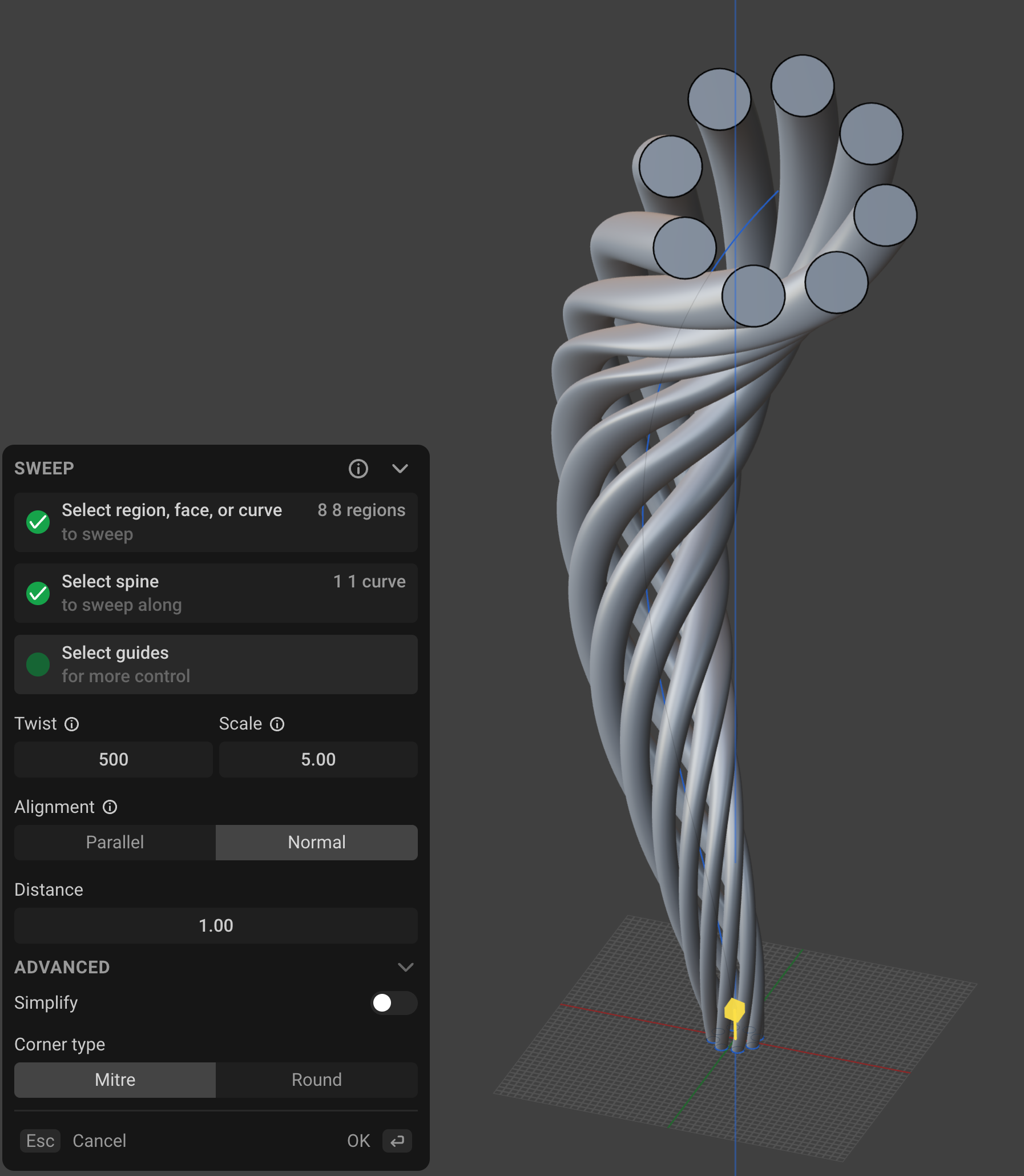

  • S1monS1mon Member Posts: 3,773 PRO
    @Derek_Van_Allen_BD
    If you're ever looking for more things to do, I'd love to see Tweep modified to allow scaling as well. Plasticity (also Parasolid based) has a scale parameter for the opposite end of the sweep.
    I also noticed that using a routing curve (multi-span degree 3) as the sweep path does not work as expected. A regular Bézier sketch works fine, or approximating the routing curve as a single span curve (or a multi-span degree 5 curve) using the edit curve function, also works fine.

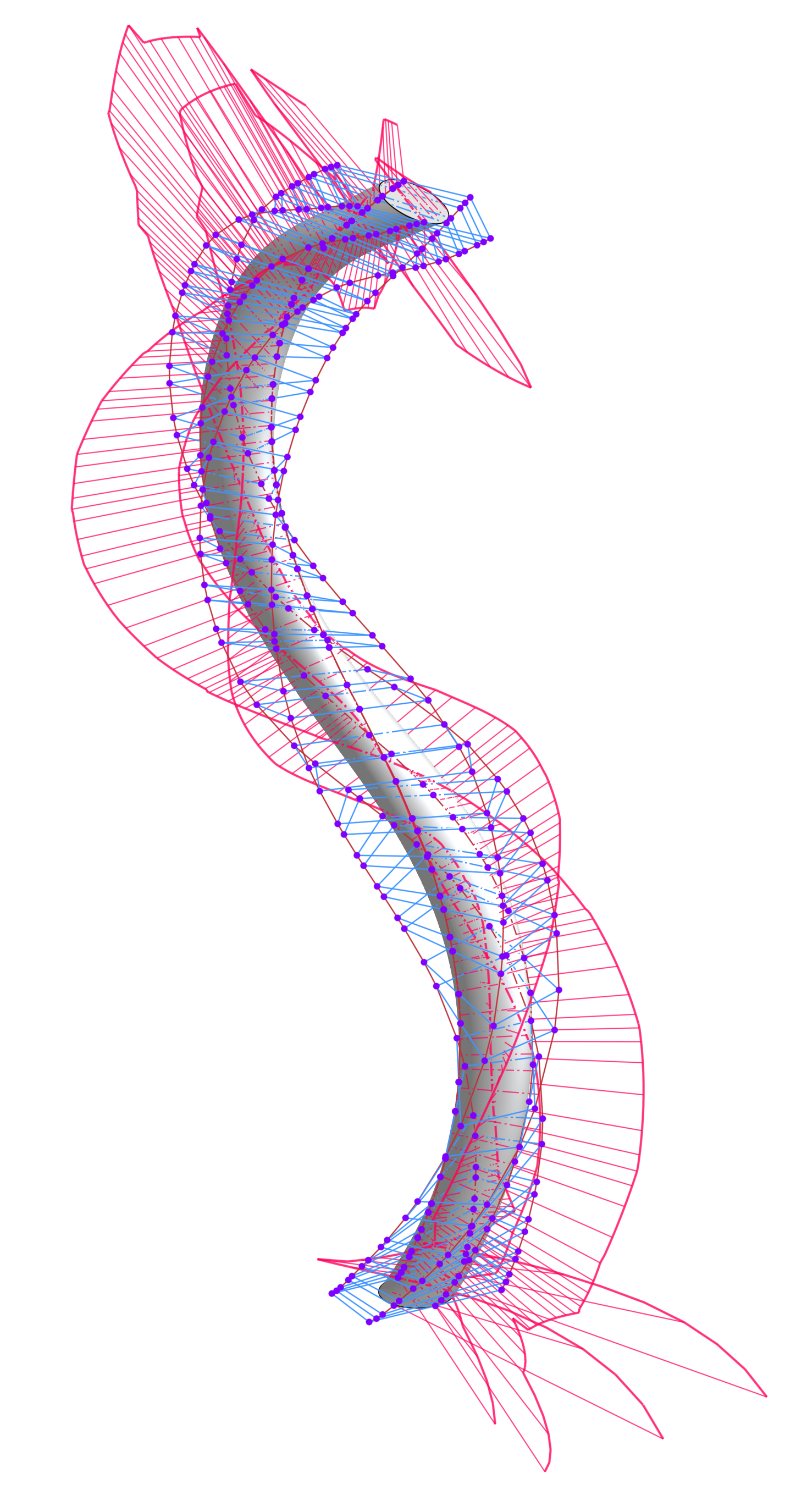

    edited December 15
    I just tried your V3 update with the routing curve sweep path. I got the same result with the uneven twists.
    I suspected that opSweep was limited. That's unfortunate.
    Honestly, I think the underlying Parasolid sweep has some really awful issues with how it creates all the needed CVs. If you display the curvature for all but simple sweeps, you'll see some really dreadful combs. The beginning and the end of this sweep (created with Tweep) have some really lumpy bits. I suspect this is all due to some ancient garbage Parasolid code.
    edited December 15
    @S1mon I won't rule out that the spiral path curvature might be to blame. I didn't do much testing on curvature analysis with the utility I borrowed. It's possible that the end point clustering needs adjusted there.
    Edit: or it's confirmed that there's some wackiness with the curvature generated with the spiral util. Guess I'm in for another day of staring at curvature combs.
    Realistically though a spiral sweep feature probably doesn't need to be the absolute smoothest of surface perfection for most people's use case. Still gonna see if a tweak to this fixes these corner cases people are discovering.

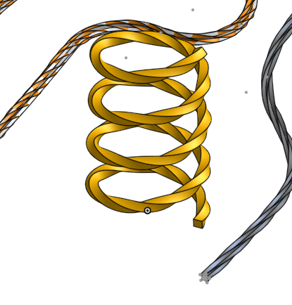

    helix needs approximated curve as well.
