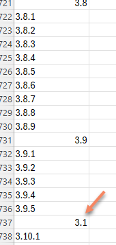

    All kind of weird stuff happening… We imported 4 machines into our ERP system and everything was scrambled. It turns out the CSV we exported from Onshape was good, but the act of opening it in Excel changes the format of the index to be "numbers" for things like 1.10, it then proceeded to truncate the trailing zero…
    So, instead of: 3.9.5 , 3.10, 3.10.1 we get:
    then the importer for the ERP overwrote what was already in 1.1 with the information in what would have been 1.10…
    I hate auto formatting sometimes. It feels like you spend more time reversing it than you do. Now they have to go through 1023 lines and check for this. And of course you can't delete anything that is in the ERP, so they have to go through and archive everything one at a time and solve the puzzle with clunky software…

    Yeah, never "open" a CSV with Excel, it will insist on being "helpful" and wreck stuff!
    Launch Excel and then "import" the CSV data so you get a chance to specify the format.

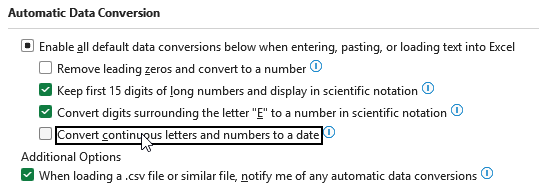

    Or go in the options and disable these two so your part numbers don't get converted to numbers or dates!

    Awesome, thanks for the tip. I didn't know there was a setting

    I turned off auto convert in excel, and it still does it… Opening the CSV in a text editor shows it is correct before loading.
    But I don't even get the warning in excel that conversions are happening, even though that is checked on
    Edit: Nevermind, it looks like double clicking the csv to open in excel ignores those options. You have to open excel, go to data, click import csv… That's annoying!
