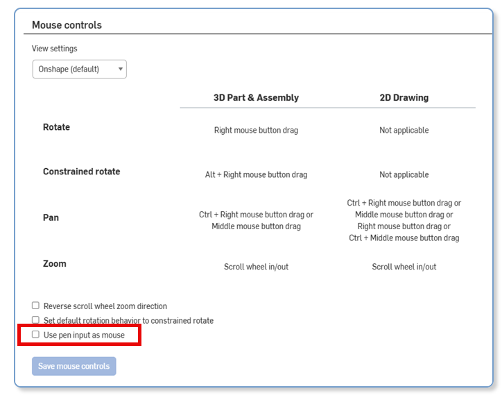

USE PEN INPUT AS MOUSE
Onshape treats stylus and pen input devices as full mouse equivalents. Users on pen-enabled tablets and touchscreen devices get a more natural and fluid design experience without any loss of precision.

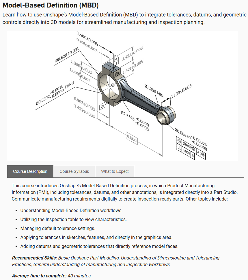

MODEL-BASED DEFINITION (MBD)
The Learning Center now offers the Model-Based Definition (MBD) course, where you learn how to work with the Inspection table and build out your MBD data directly in Onshape.

    Thanks for the MBD learning module.
  • Cary_BettenhausenCary_Bettenhausen Member Posts: 50 PRO
    Happy to see the MBD course in the Learning Center. I'm looking forward to adding that shingle to my collection.
