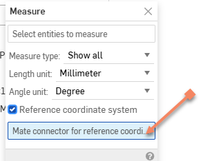

MATE CONNECTOR AS REFERENCE COORDINATE SYSTEM FOR MEASUREMENT
The measure tool accepts a Mate Connector as a reference coordinate system, returning dimensions relative to both the position and orientation of the selected Mate Connector rather than the default coordinate system. A new quick list view for measurement selections also makes it faster to review and remove any selected references.

    Like the mate connector reference in measure

    These weekly sprints are just awesome. just yesterday I was pondering if one could measure with xyz in a mate connector reference space and there it is! I feel psychically connected to the onshape team today…

    Agreed that referencing a coordinate system for measurement is useful, but it seems that the measure tool does not work inside of editing a sketch anymore, meaning it will exit the sketch first and remove any prior selections made. Unless I'm mistaken I don't think it was working that way before.

    Referencing a coordinate system for measurement. This will be a huge upgrade to my workflow. Thank you.
  • jacques_spillmannjacques_spillmann OS Professional Posts: 74 PRO
    I'm not happy with the measuring tool updates😕:
    1. you can't use it inside of a sketch like we use to
    2. clicking on the background does not clear the selection anymore
  • S1monS1mon Member Posts: 4,077 PRO
    With the new “use pen input as mouse” preference, I can now do some more things in Onshape in the browser on my iPad, but I can’t seem to double click. Single click and hover are working. Is there something else that I need to change?
  • GregBrownGregBrown Member, Onshape Employees, csevp, pcbaevp Posts: 386 image
    Please check again tonight (18th) for using inside a sketch.
