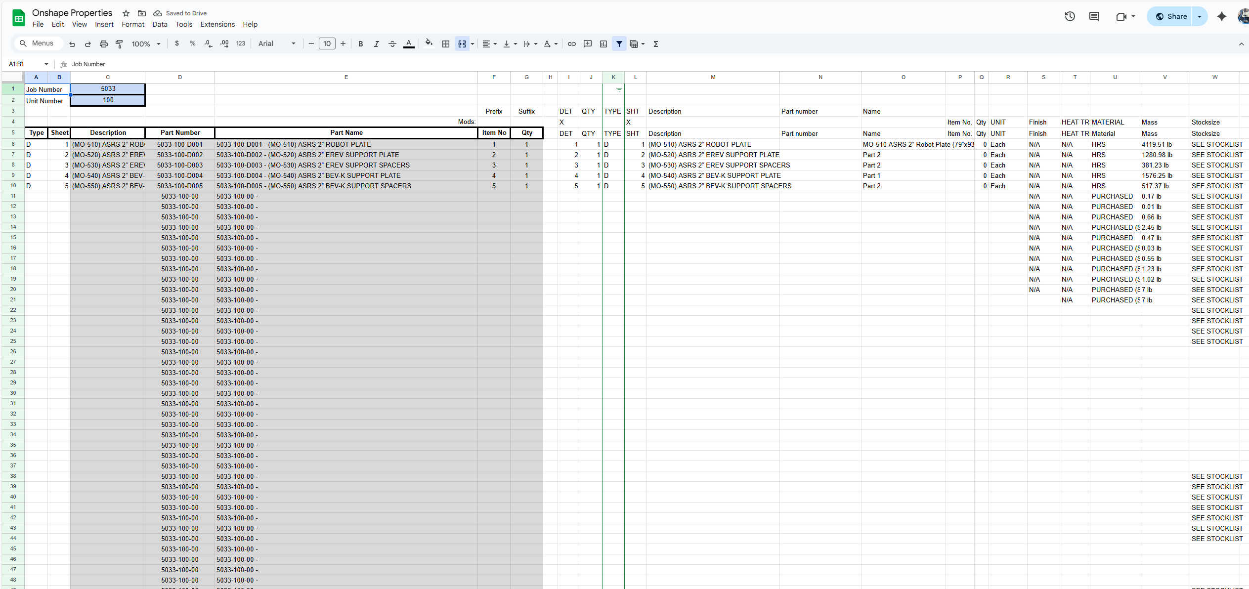

  • john_mcclaryjohn_mcclary Member, Developers Posts: 4,048 PRO
    you can edit bulk properties buy pasting them into the BOM at the assembly level
    I usually edit hundreds of parts in just a few clicks
    I've just created a google sheet that I edit the top two blue squares.
    Then paste the BOM from the model on the right hand side of the sheet.
    Change a couple DET numbers or Sheet numebers using spreadsheet tools to automate that.
    Then the result is on the left grey area. I copy that, then paste it back into the BOM in Onshape. Give it a few seconds to apply and you're done
    works the same for 2 parts as it does for 200 parts
    Then you reference the part properties vie the Sheet Reference option in the drawing
  • martin_kopplowmartin_kopplow Member Posts: 1,259 PRO
    @john_mcclary , I see how you do that. It is a bit of a loop, but could be a way to consolidate properties in an existing assembly. New parts will require another run.
    I guess we need autofill in BOM, don't we? :0)
