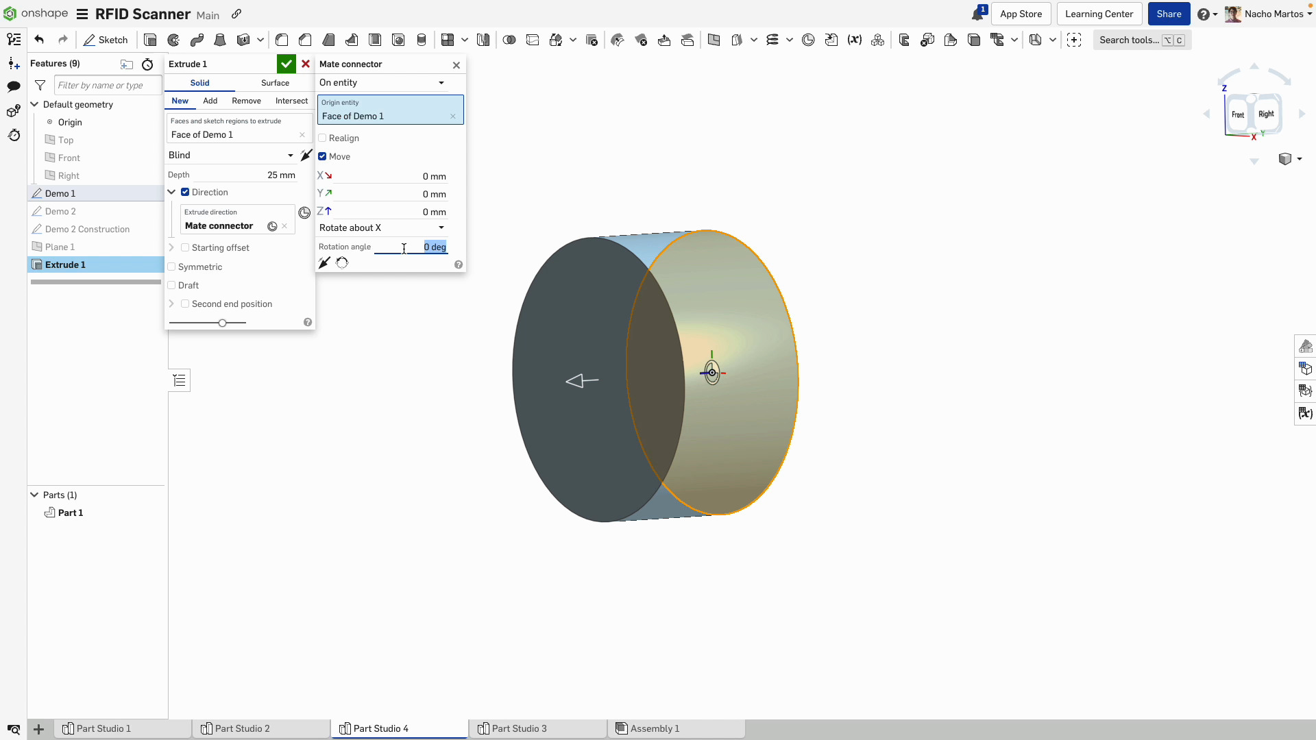

OMG I googled this thinking I was being narrowminded for missing this. Has this been added in yet?
It was over 2 years ago:
Improvements to Onshape - February 3rd, 2023 — Onshape
There's now a "direction" option in the extrude tool (been there for a while)…
