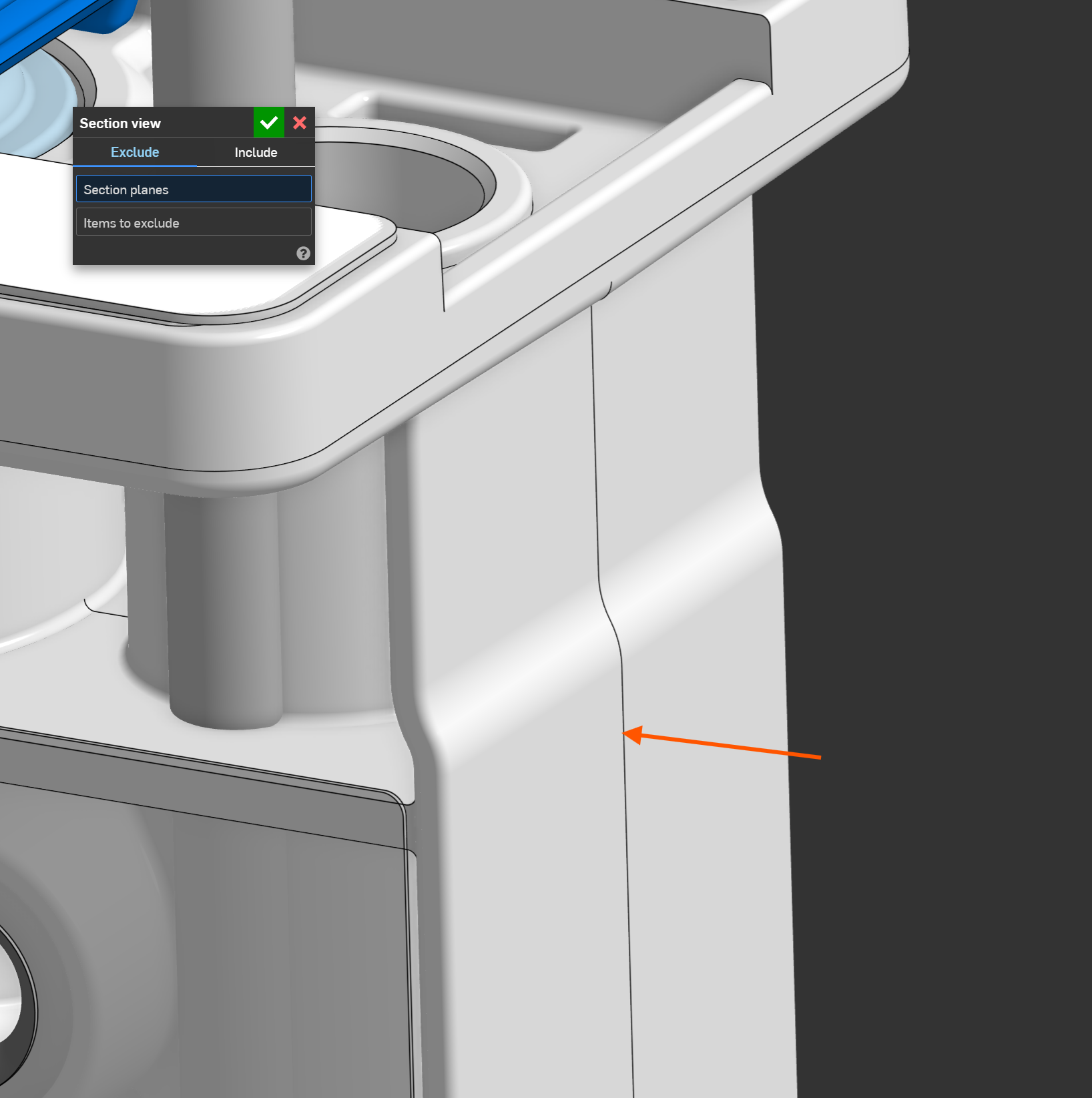

    Ok so I get how mate connectors work but I genuinely think there are use cases for planes in assemblies. Let me give you an example.
    In the image attached you can see a cropped view of a part I'm working on. I would like to create a section view in the direction of the arrow. Problem is there are 0 flat surfaces on this part in that orientation. Every surface is drafted. The 'section view' tool is asking for a 'Section Plane' But I have none to work from. So I ask you all. How do I create the section view in this instance? Please don't tell me I need to create a surface in the Part Studio and then insert that into the assembly to use as a reference.
  • S1monS1mon Member Posts: 4,082 PRO
    Oh believe me this is one of my biggest gripes in Onshape, but in this case, I would try selecting the cylindrical face of the hole that's nearby since I assume it's on the same plane as the draft split.
    If that doesn't work, I would make sure to add either assembly MCs or part MCs that correspond to commonly used section planes. Worst case, you can add big rectangular sketches and assemble them to make something that's easy to select and hide.
