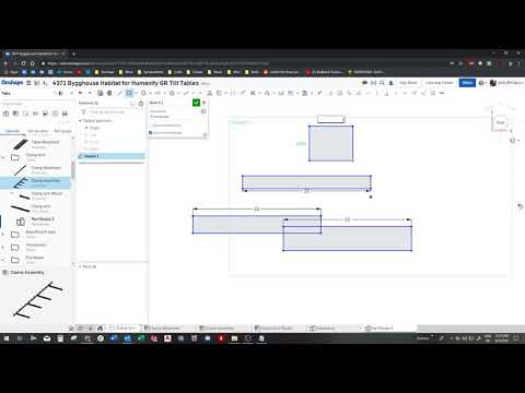

  • john_mcclaryjohn_mcclary Member, Developers Posts: 4,052 PRO
    Here is it happening most of the time when  in a fresh part studio
    I tried to type loudly so you can hear the  difference between a enterkey stroke and the #2
    i am just hitting 2 enter 2 enter
    you can see how i get slower and slow until it finally accepted the entire "2-enter-2-enter" input
    manytimes the enterkey was the ignored stroke as you can see a lot of 22" long rectangles
    I know this is easy to push away as "you should just slow down' but that is normal speed when entering dims. I accept a double input when I typo, but the system makes significantly more errors  than me, even when slowing down a lot.

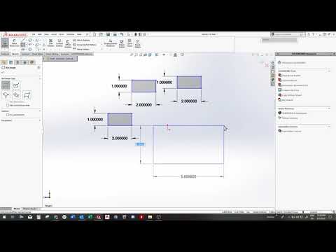

    for comparison, here is the same demo in Solidworks, this is what is expected when entering dims:
    https://www.youtube.com/watch?v=UCj1-xBUFto
