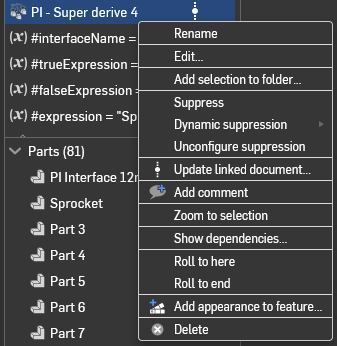

  • ry_gbry_gb Member, csevp, pcbaevp Posts: 112 PRO
    I don't see an option for "Open linked document" with Super Derive as I see with Derive. Is that because Super Derive is a Featurescript and doesn't allow for that functionality?
    Ramon Yip | glassboard.com
  • Derek_Van_Allen_BDDerek_Van_Allen_BD Member Posts: 451 PRO
    edited December 16
    Need this for Amalgamate. Digging into it.
    Edit: wait, Amalgamate already has this. Maybe it's just a featurescript version number thing with PartStudioData where older versions didn't support it?
    Edit edit: It's not even a featurescript version thing, I think it's a document version thing. I just copied the exact code from Super Derive and got it working in a fresh studio. To get this to work I think all that needs to happen is for @NeilCooke to update the Super Derive document to the latest version of Onshape and push a version and you'll get the ability to open links back to the reference.
