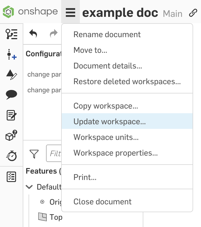

  • lanalana Onshape Employees Posts: 761 image
    @Michael_Bills Please tru Hamburger menu/Update workspace.

  • EvanReeseEvanReese Member, Mentor Posts: 2,869 PRO
    @Jan_Stegmann Might be missing something, but have you tried this new-ish option?
  • dave_friesendave_friesen Member Posts: 5
    "Update workspace…" worked for me for copying simple shapes that had been throwing an error.
