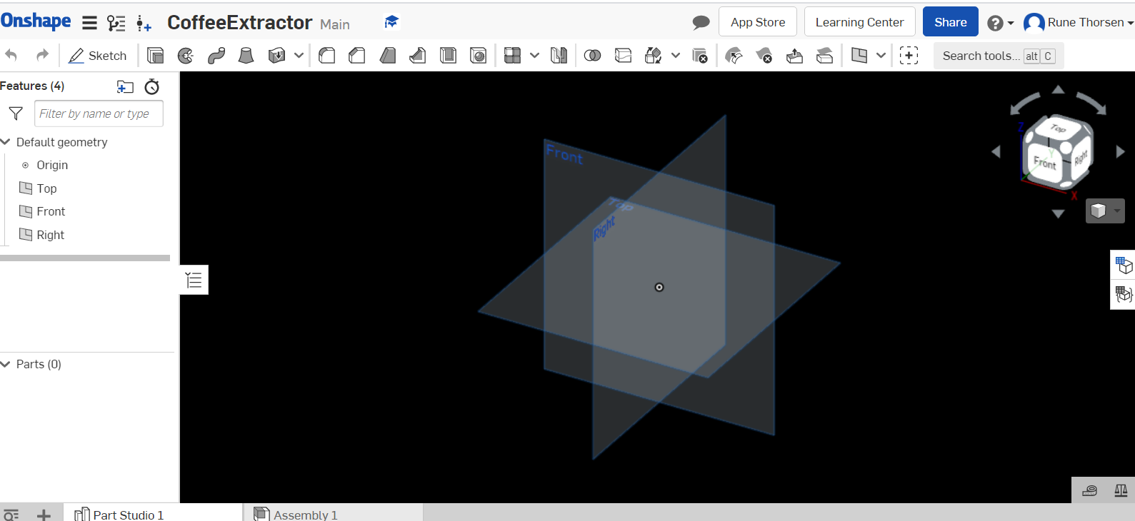

  • rune_thorsen229rune_thorsen229 Member Posts: 182 EDU
    Got the same Issue, no possibility for changing driver as I'm not admin and on old hardware - waiting patiently for an upgrade. In the meantime I have to work on this:
    I do like black bacground however so I would suggest that you could let the user decide and maybe also let the toolbars and featurelist be on black background.
