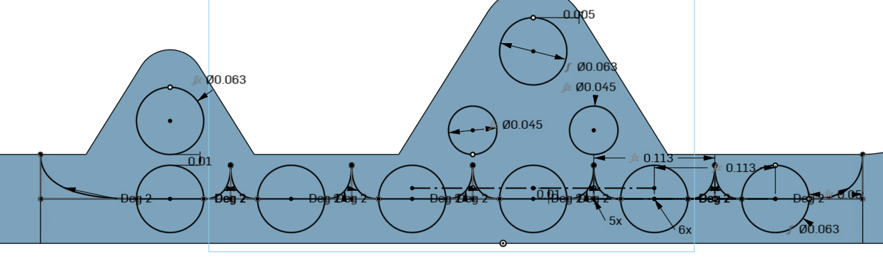

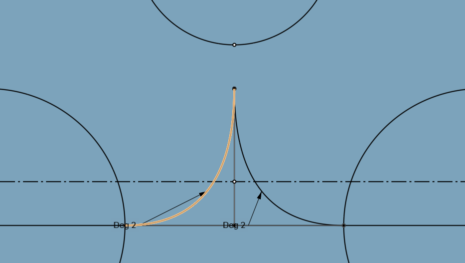

Okay so I was sketching on an extrude, and everything was all fine and dandy, then I added some beziers between the circles, and now the circles aren't able to extrude. I'm also not able to select any faces? I can extrude surfaces like the edge of the circles but not the circles themselves, which is really odd considering the circles aren't constructions. Help? Any help is much appreciated!

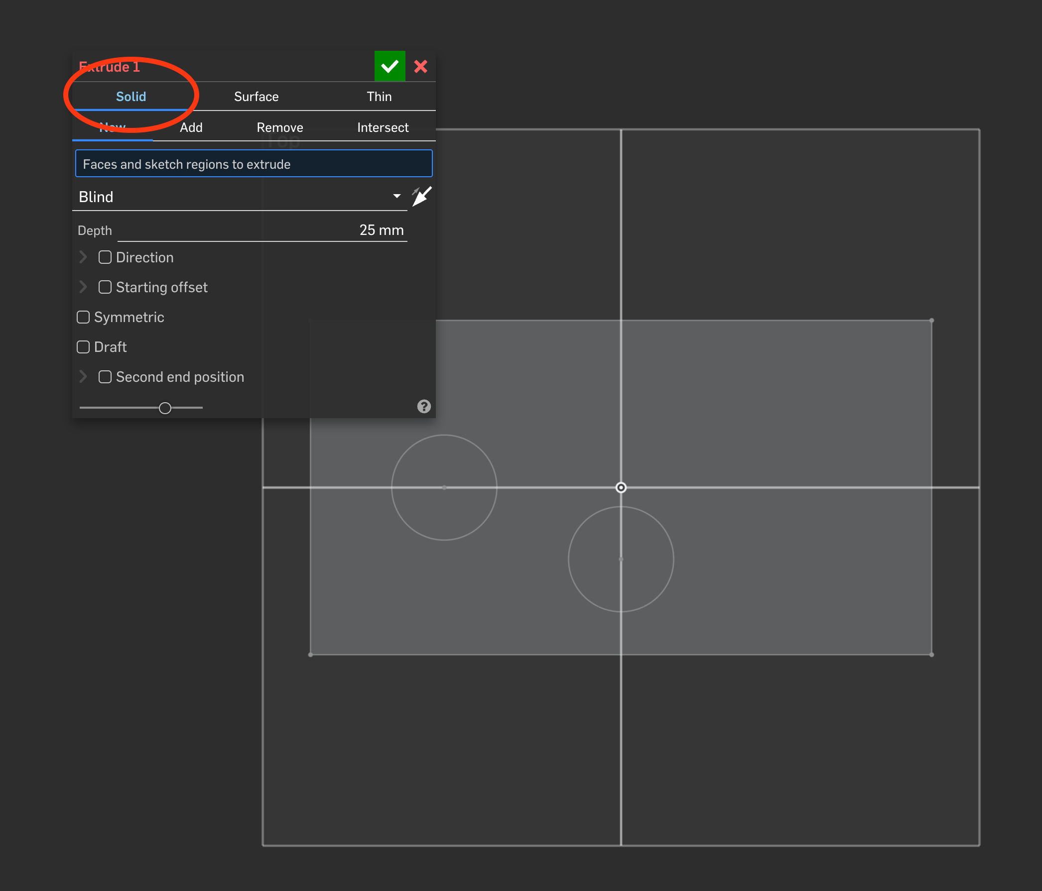

  • GWS50GWS50 Member Posts: 500 PRO
    Do you have 'Solid' 9rather than 'Surface' selected in the extrude dialogue window?
  • CADNurdCADNurd Member Posts: 99 ✭✭
    Hard to say exactly without the file, but most likely it's correctly refusing to extrude those arcs. A 'solid' extrude doesn't work with lines/arcs or anything which has zero cross-sectional area.
  • sam_smith744sam_smith744 Member Posts: 8
    I'm not sure I really follow what you mean because like I said I was able to extrude it earlier, it only stopped working once I added the beziers. Anyway heres a link to the file if that helps: https://cad.onshape.com/documents/95b7f8ff840fedb712867228/w/5db8fb328391ae388c434693/e/67a968a1c16a7198b359f0a3?renderMode=0&uiState=69717011c3f15d4664af6e16
    It was because of the stupid beziers thanks guys
