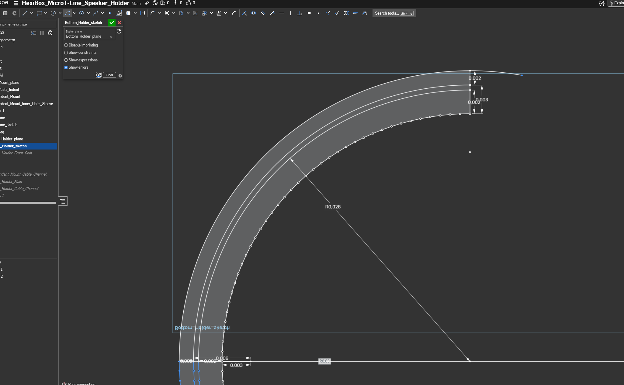

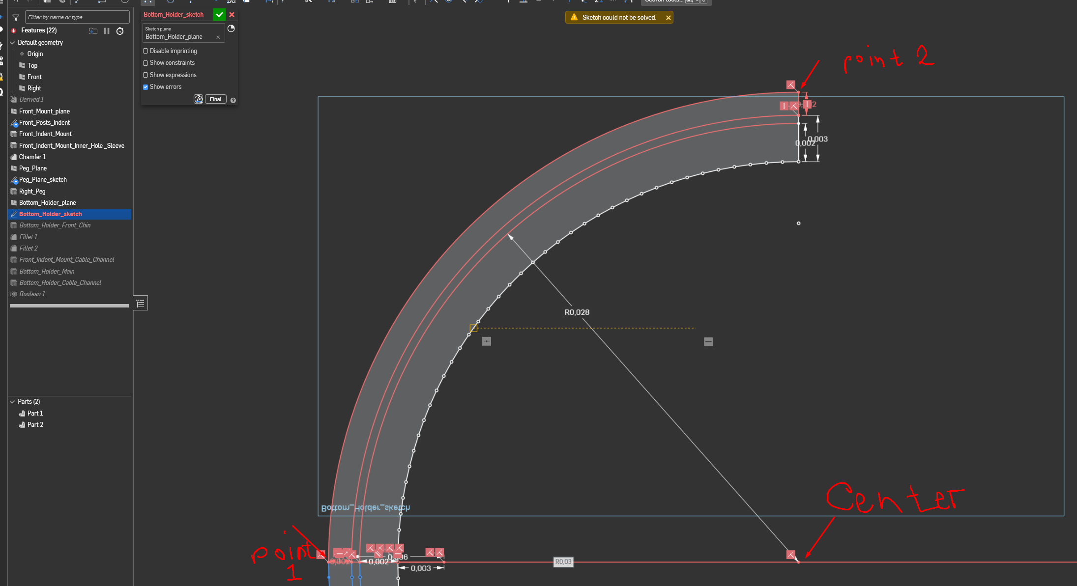

So, I want to put an arc in my sketch. I have a center point, I have a point where I want to start this ark and where I want to end it. So I use the center point arc tool and watch how half of my sketch get's lid in red, like so:
But when I do literally the same thing, but instead of ending ark in one of those two points, I continue the arc just a little bit further - everything is ok, sketch resolving correctly:
And that would be fine except that now I'm getting a loose end in my sketch. Which makes me a bit annoyed.
As far as I can see, it does not matter which direction the arc is made - the result is always the same. It precisely passes through both point 1 and point 2, but everything resolves correctly only when I get it past the ending point.

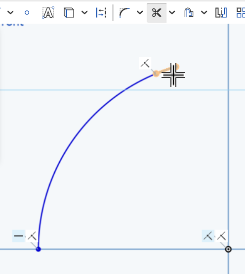

  • Chris_BeckettChris_Beckett Member Posts: 22
    That is strange. I can't comment on why it's red. But since it works if you go past the point, what if you just use the Trim tool to trim off the loose end?
    If that doesn't work then probably something is not lining up the way that it seems.
