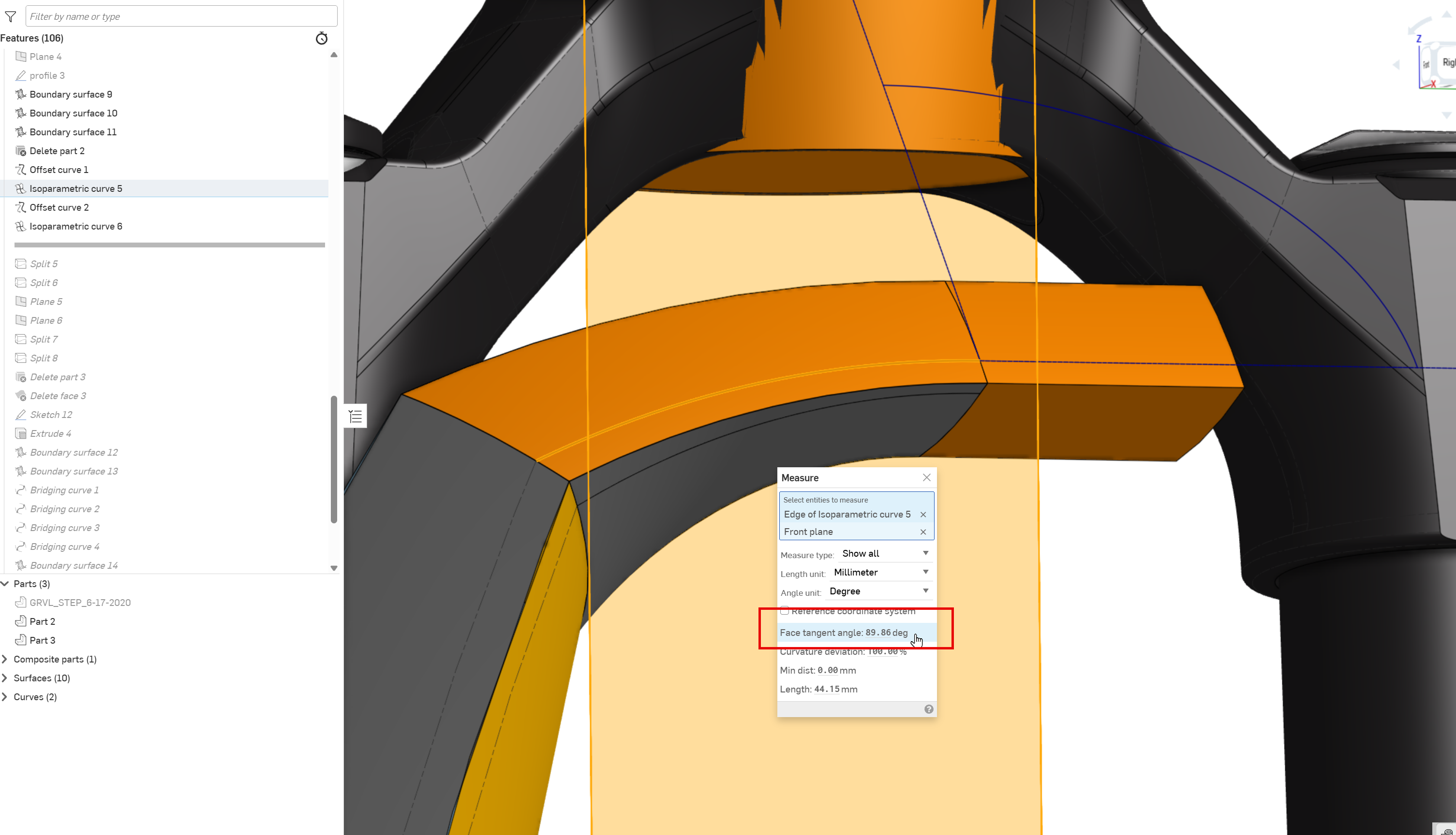

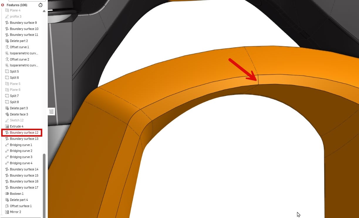

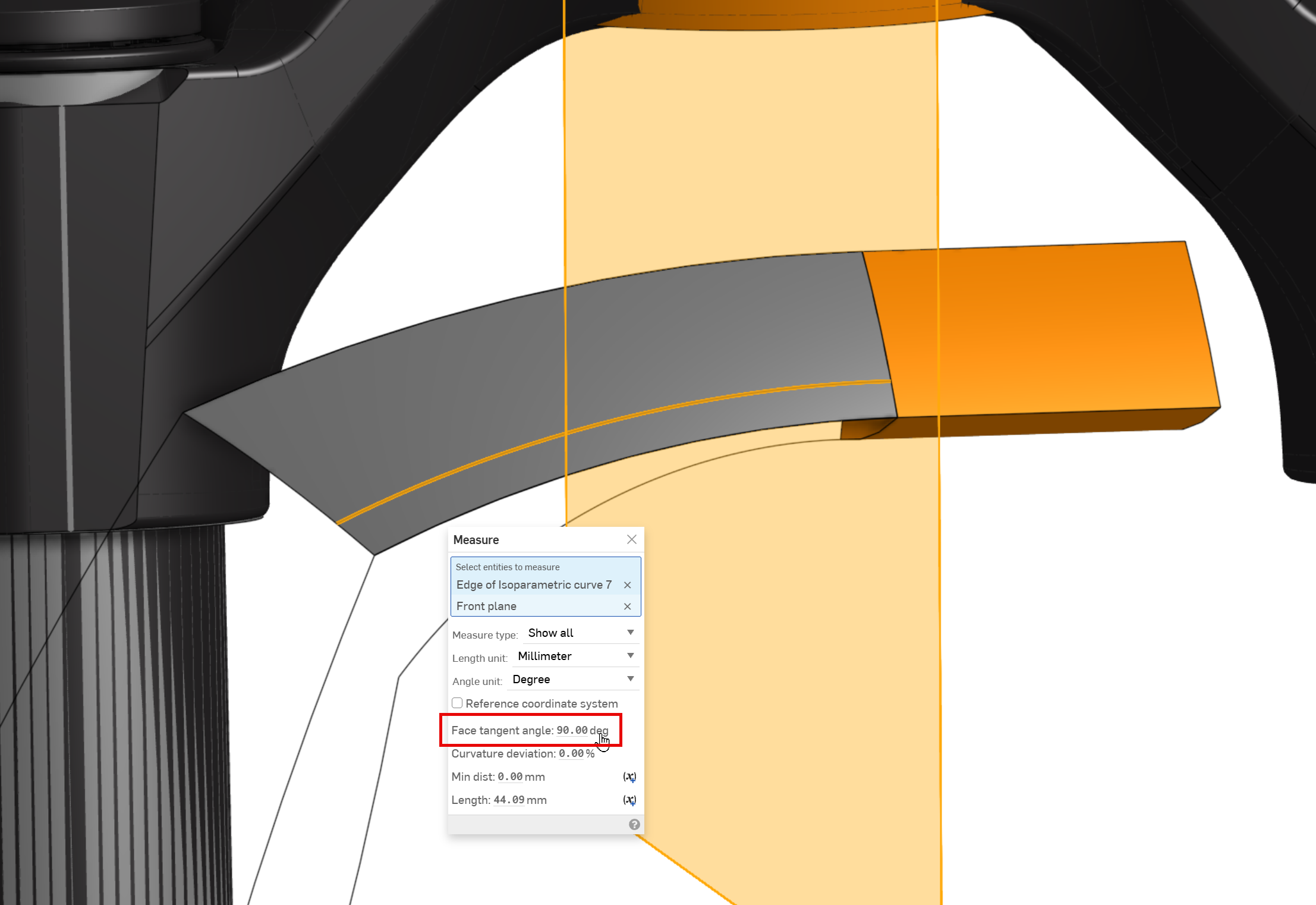

    Just noticed “Improved quality of boundary surface from curves” in the change log. Any more details on this?
  • NeilCooke
    NeilCooke Moderator, Onshape Employees Posts: 6,125 image
    There is more to come on this, so stay tuned. Just be assured that boundary surfaces are better quality than before.

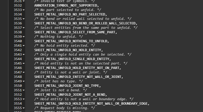

  • Derek_Van_Allen_BD
    Derek_Van_Allen_BD Member Posts: 1,165 PRO
    I also see some new sheet metal functionality creeping into the logs. Looking forward to all of the new unintended use cases these might enable.

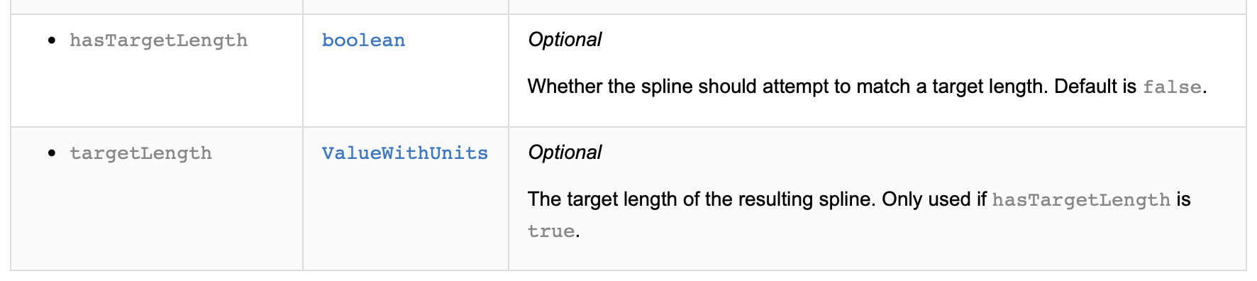

    In the spirit of hidden updates… a little birdie just told me to look at opFitSpline.
    https://cad.onshape.com/FsDoc/library.html#opFitSpline-Context-Id-map

  • NeilCooke
    That was in the last release, but we forgot to document it 😯

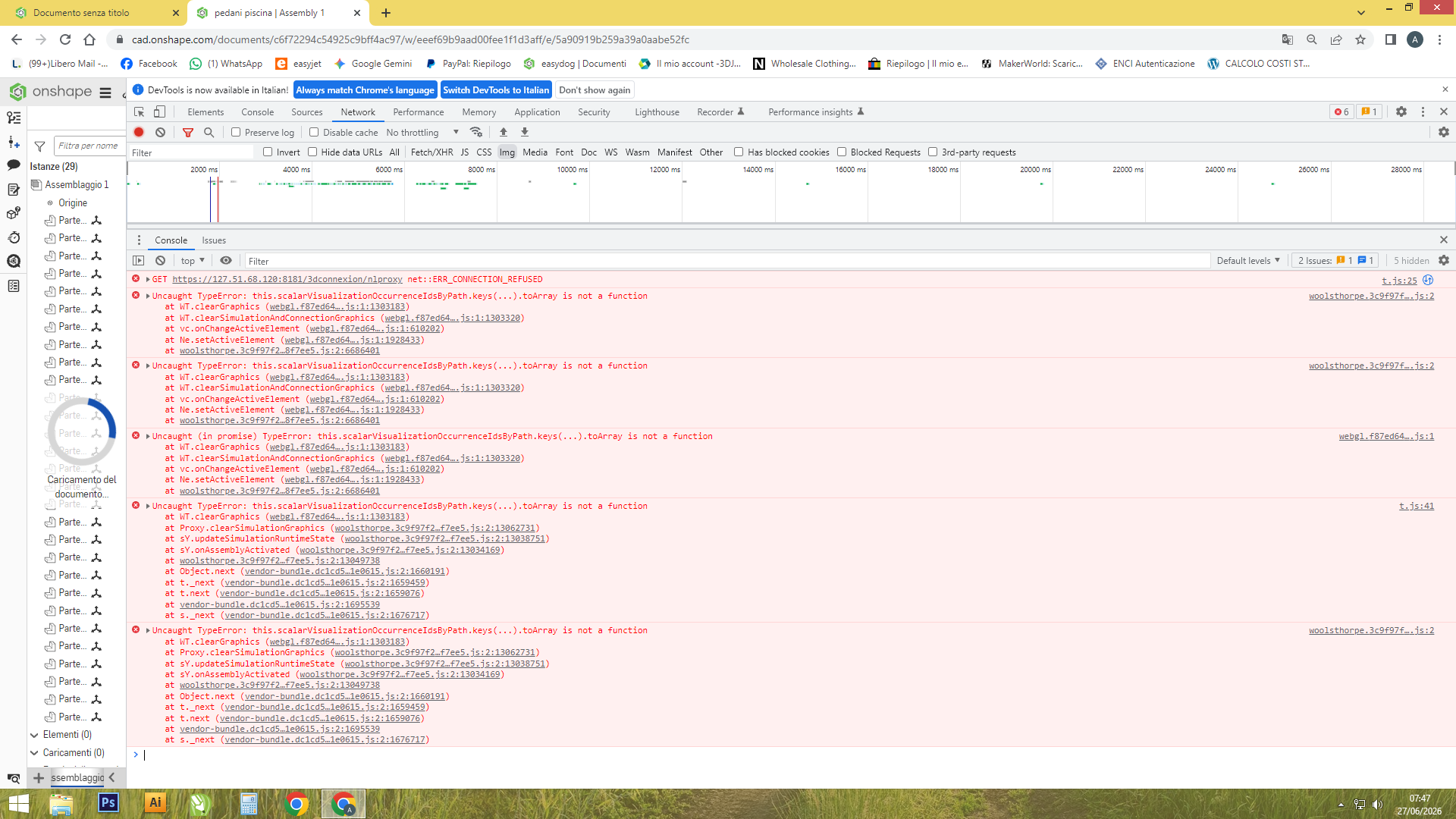

  • antonio_mattana
    antonio_mattana Member Posts: 2 ✭
    TypeError: this.scalarVisualizationOccurrenceIdsByPath.keys(...).toArray is not a function.

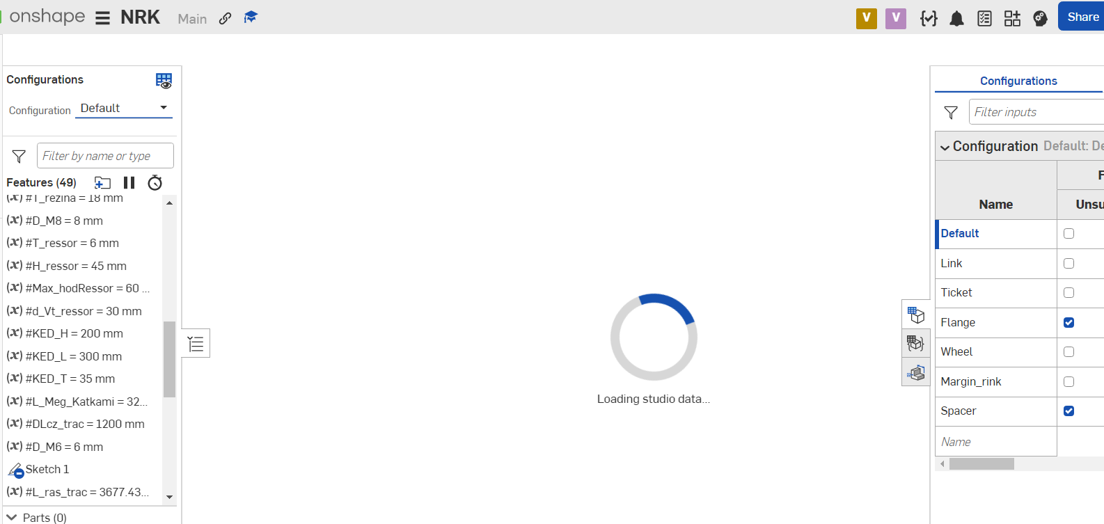

  • volodymyr_biliakov
    volodymyr_biliakov Member Posts: 3 EDU
    Help! After the last update, the variable table disappeared, drawings do not open, I cannot change drawings. I tried restarting, changing the browser, clearing the cache, nothing helps.
  • Paul_J_Premakumar
    Paul_J_Premakumar Member, Onshape Employees Posts: 238 image
    Thanks, I sent it but they are still silent, I thought maybe someone had something similar. I tried on another computer (although the OS, system and settings are the same) but nothing works. There was some update on 06/26/26 after which such a problem occurred.
  • EvanReese
    EvanReese Member, Mentor Posts: 3,095 PRO
    Yeah this one was from the target length addition to Routing Curve last release, but I love that it's just part of opFitSpline now!
    Thank you, everything is restored.

    @Nick_Holzem @NeilCooke
    In order to see the improvement in Boundary surface, I assume that the feature needs to be recreated?
  • Nick_Holzem
    Nick_Holzem Member Posts: 250 PRO
    @S1mon yes, I needed to use a new boundary surface.
