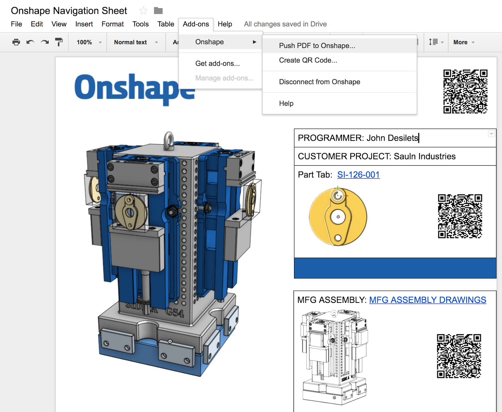

Onshape PDF Add-on
The first tab in the Document is a setup sheet called “Onshape Cover Sheet.” This was created in Google Docs as a template and was pushed into the Onshape Document through an add-on. In this example, the purpose of the add-on is to allow you to update your setup sheet as the project evolves with one click. The add-on also allows you to create a QR code from a URL automatically. This add-on is unique and is currently still pending further development. We are looking to generate interest before releasing it to the Onshape App Store. If you think this add-on would be useful to you, please let us know. We’d appreciate your suggestions and feedback.
@brucebartlett
@bryan_lagrange
PDF Example In Detail
The “Onshape Cover Document” utilizes hyperlinks to navigate between different tabs in the Onshape Document. The example sheet also contains QR codes that are tied to tabs in the Document as well. This allows anyone to navigate through the Document quickly by clicking on a link or scanning a QR code. If you are on a tablet, you can easily press on a link and be brought right to the tab. If you have a printed copy of the setup sheet, you can scan the QR code on any device and be brought right to the Onshape Document tab as well. The best part about all of this is that it is secure! Only users who you have shared the Document with will have access. This gives the shop floor setup person the ability to scan the code and locate the information they need quickly, efficiently, and securely. As long as the PDF document is up to date, the setup person will always have access to the latest version.

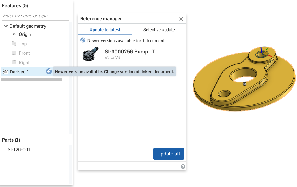

I originally designed this project for a demonstration to show multi-company collaboration. From part design to manufacturing, the demo story goes as follows. I am a job shop manufacturing company with many CNC machines in house. My customer, Saulin Industries, has shared a document with me with a part to produce. I am able to communicate directly with my customer through Onshape to discuss project details. We can exchange information such as scheduling, quoting labor cost, or just general questions regarding the process. After the Document is shared with me, I can tie the part into my process for the manufacturing. Since we are sharing the Document, if my customer pushed an update, I am able to see a newer version is available and can version my workflow as needed.
On my end, playing the role of the manufacturer, I need to choose my approach on how to produce the part. This approach includes what work holding device to use, the stock size, the CNC machine appropriate for the part, and programming the tool paths in CAM. When I am done producing the tool paths, I can load the CAM project into the Onshape Document to store in a version or branch. Now I have the entire manufacturing project in Onshape and can share this out to the shop floor for production. If an update is pushed from my customer, I am able to see this change and adjust my manufacturing project to suit. To do this, I can create a version or a branch and adjust my project to manufacture this part in the same workspace. I will need to update the CAM project in Mastercam and after that is complete, I can load the new CAM project into the version or branch of Onshape that I just created.

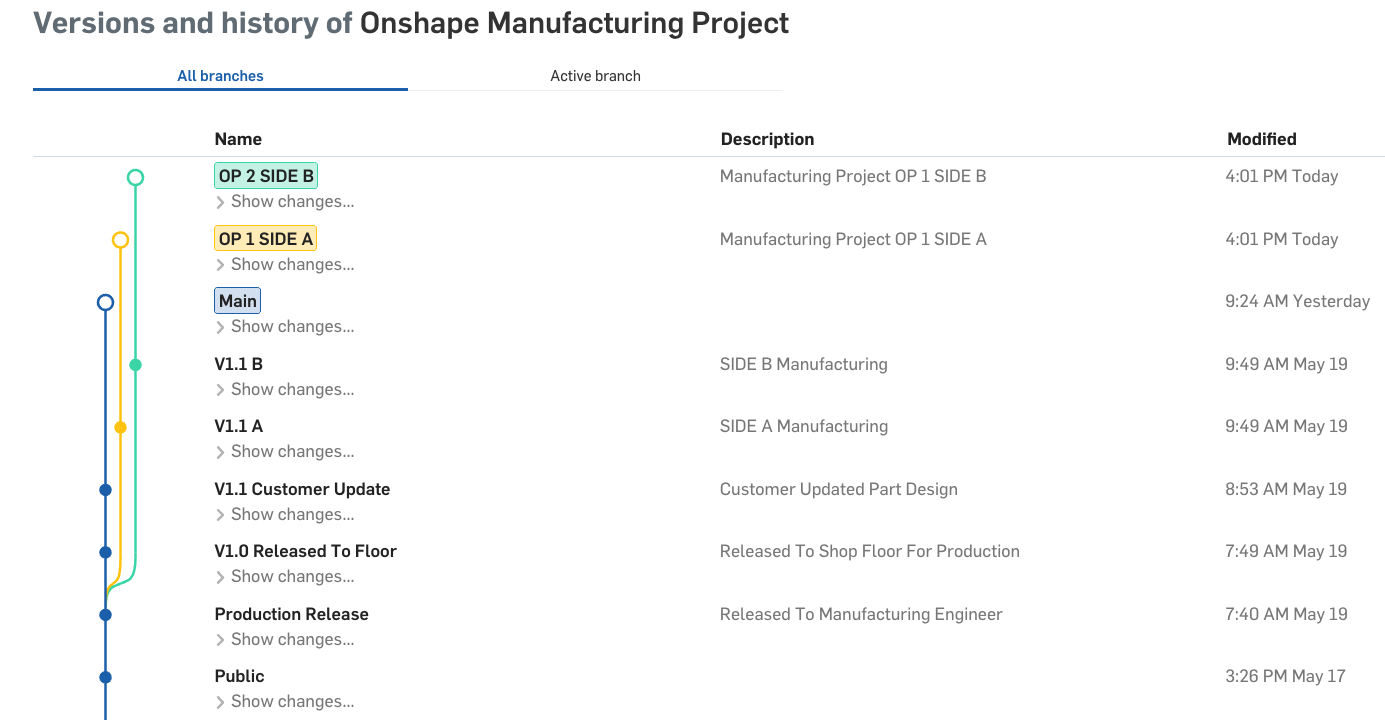

CAM Project Version Control
For version controlling the CAM project, I simply made a branch for OP1 and OP2 and loaded the corresponding CAM project into that branch. OP1 to branch OP 1 SIDE A, and OP 2 to branch OP 2 SIDE B. This is the beauty of a built-in PDM system!

    How do we get @lougallo 's  Google Doc App?
  • John_P_DesiletsJohn_P_Desilets Onshape Employees, csevp Posts: 271 image
    @brucebartlett
    It is not available as of yet. It's just a prototype. We are looking to generate more interest before making it official.
