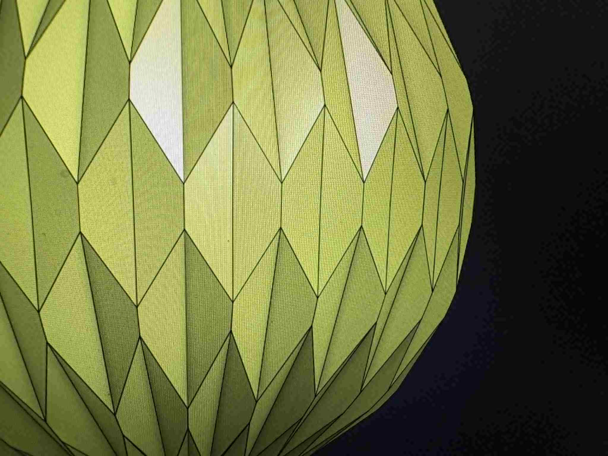

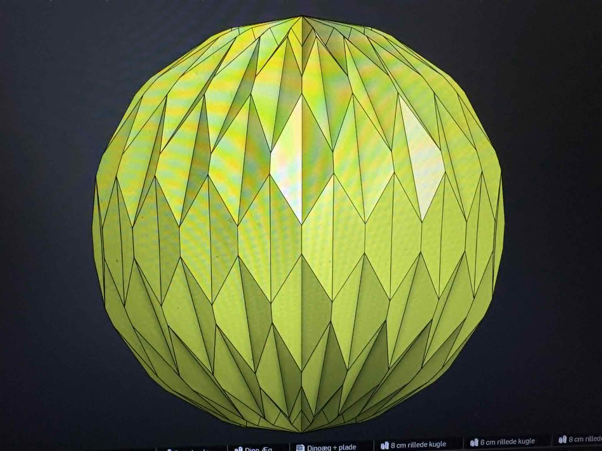

hi pretty new to Onshape and cad it self by like that u Can design things and I get better all the time.
my wife has this clock witb a nice pattern and really want a patten like that on a sphere also and maybe other things
But sad to say after a few (lot) tryes its more than I Can at the moment 😔 Can anyone lead me the right to understand how to do it.
i add pictures of the clock so the pattern Can be seen.
hope someone I abel to help😊
regards
Hey @steen_pedersen968, there are several ways to get shapes similar to this.
Here is one way to do it by sketching the profiles then lofting them together and creating a circular pattern:
https://cad.onshape.com/documents/70301bdee67da94c01f314aa/w/faadf4a93585be3342174450/e/525c…
Don't forget to checkout Onshape's Learning Pathways a fantastic way to learn how to use Onshape to it's fullest potential.
@MichaelPascoe thx i will look into it when i get home tonite and see if i can learn it and then get it around a sphere and maybe some other things aswell :)
thx @MichaelPascoe i will look at it tonite and see if i can learn to do it so i can make it on sphere and other things så i get a happy wife :)
try it in my lunchbreak and doing it self 😀 i really learning here but I came to a hold with loft2 dont know a smart Way to selecet transforme in i so gotts look more tonite and hopefully do it 😃😃
Here, I simplified the steps a bit. There were a few redundant things.
Note that Sketch - Profile B, uses an implicit mate connector to control the angle of the sketch plane.
https://cad.onshape.com/documents/70301bdee67da94c01f314aa/w/faadf4a93585be3342174450/e/525c24c…
@MichaelPascoe thx have work something with a sphere design but just need to figure out the middel part on looks weird :)
just have to figure the big part in top out so that can be in the middle aswell :)
The point with this kind of shapes is to get the brain to accept that they aren't what they look like at first glance. This, for expamlpe is not a sphere at all. It might not even have the tiniest spherical surface in it. Once that is established, things get a lot easier. ;0)
im almost where my wife want and learned a lot :)
the onlything a miss now i som dept in the middle square field u have any idea to get that
hope u can help @MichaelPascoe or else i will be like this :)
I see what you mean, just adjust your sketch profile in that area to have more depth. \__/
