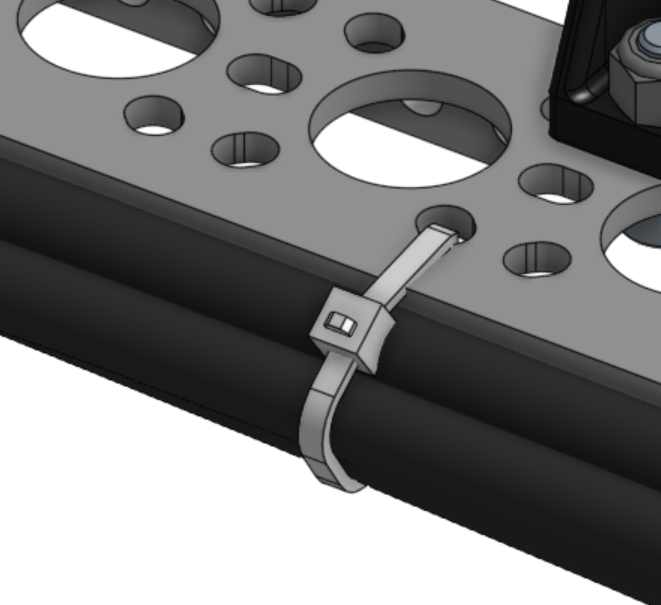

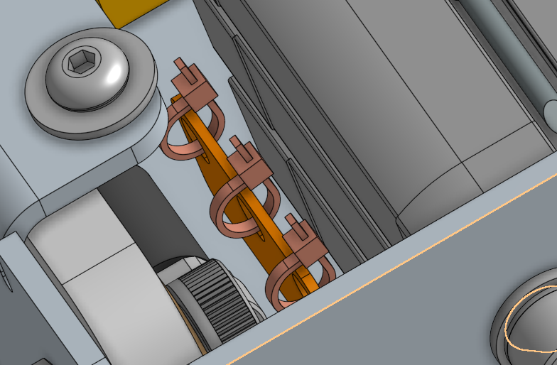

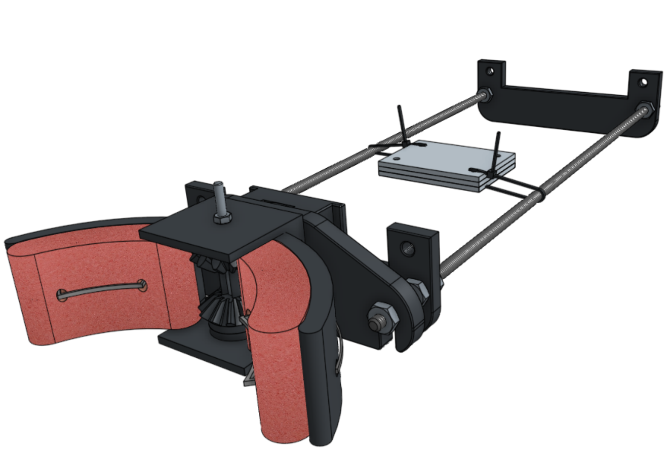

  • imants_smidchensimants_smidchens Member Posts: 69 EDU
    oh sorry i forgor about this thread
    ended up writing a janky custom feature for it
    snag it here
    https://cad.onshape.com/documents/1916fc024819252e0598d659/v/491a4940a6b927aea52f768b/e/cd4e167e2b624f0303fcd83a
    Screenshot From 2025-11-21 02-09-30.png Screenshot From 2025-11-21 02-04-34.png
