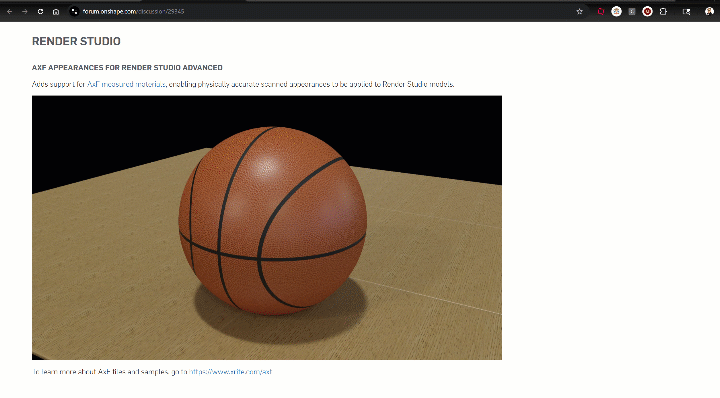

RENDER STUDIO
AXF APPEARANCES FOR RENDER STUDIO ADVANCED
Adds support for AxF measured materials, enabling physically accurate scanned appearances to be applied to Render Studio models.
https://onshape.wistia.com/medias/hu6lnylg5x
To learn more about AxF files and samples, go to https://www.xrite.com/axf

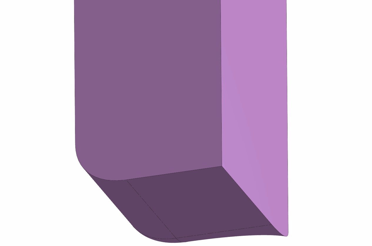

    I think I found an slight issue with the graphic control change. Setting the line width to minimum makes it difficult to select edges at times. Turning it up to max and not spinning the model allows me to select the edge no problem. I'm doing it with fillet but I'm guessing its an issue in general.

    I edited my edge selection comment to include context motion gif.. It seems somewhat related to the orientation of the edge and what else is around it to select.

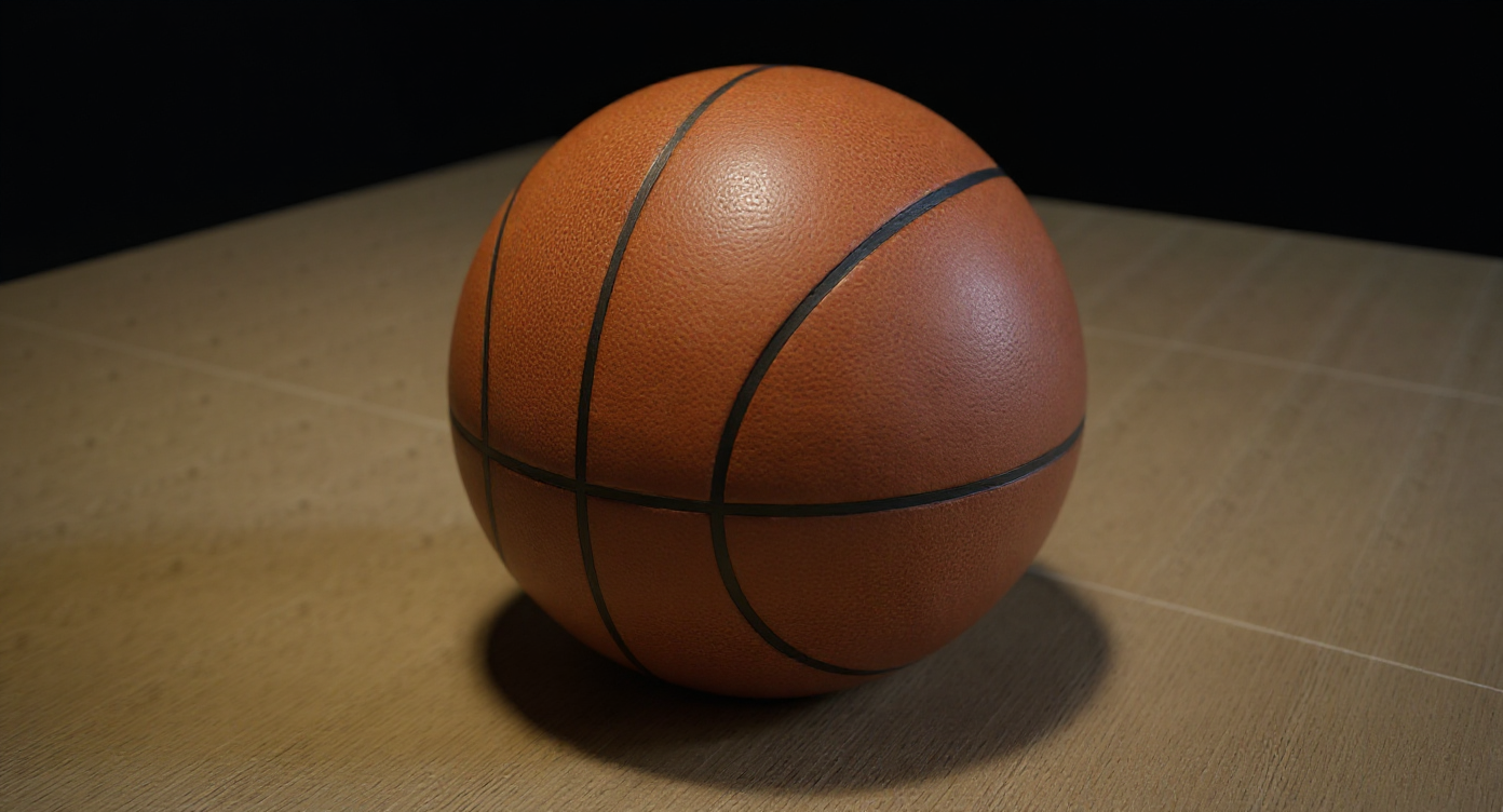

    Always appreciate these Render Studio improvements.
    Now just pop that image into RenderCAD and presto😎
