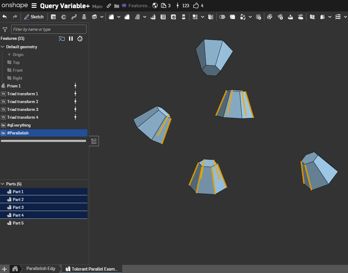

    AND then I went for a walk and realised a better way to implement it that's more compliant to the original Query Variables UI. So please disregard v1 and use V4 wich requires 11 small code changes/additions…
    I've also added a "Parallelish" query in my new version V6. It's a tolerant parallel query that allows a set angle tolerance. Comes in handy to filter for edges with some draft on them.

    @Derek_Van_Allen_BD : Thank you for integrating it so everybody can benefit from a great QV+ feature.
    I expect to use the parallelish a lot to fillet edges of injection molded parts after implementing drafts already. any tranverse fillets will then propagate easily accross the tangent edges…
    @EvanReese my parallelish implementation uses the queryFilterCompound.Allows_direction filter so any direction will work. And it works on multiple parts as well.

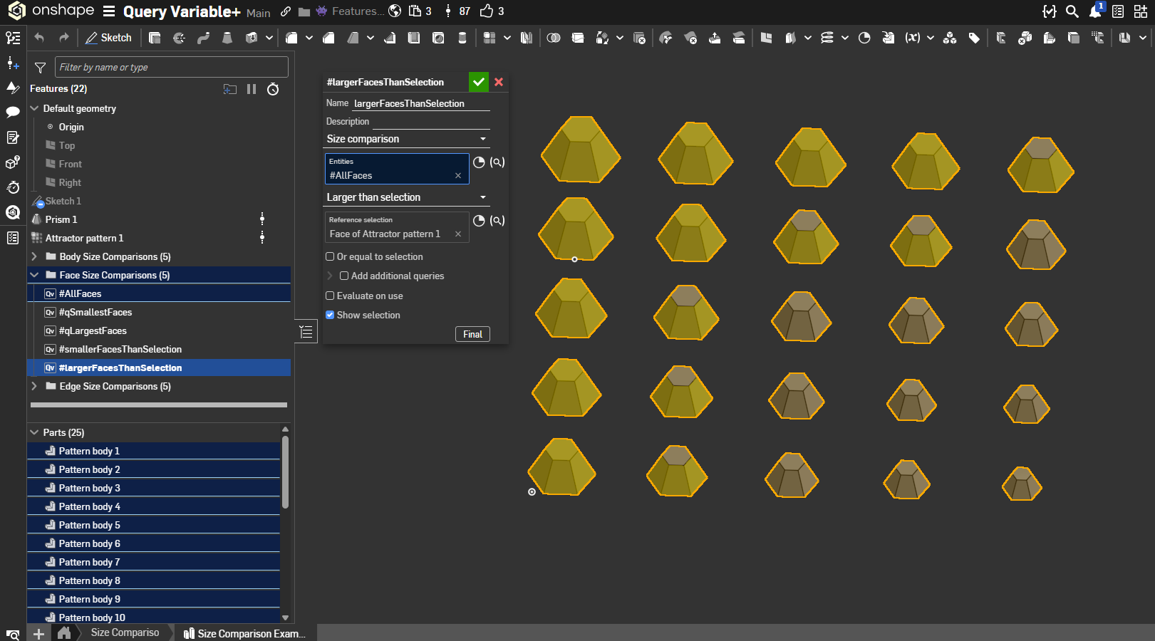

    Size Comparison query operations added. qLargest, qSmallest added with vanilla operations and I've added Smaller Than and Larger Than conditions to the pool as well to do some power filtering of geometry of interest for features. Helpful for simplification on import geometry where you might want to delete small errant faces or bodies or other cleanup operations you'd like to make more parametric.
    Oh and there's some tolerant Equal To filtering in there if you're looking to include geometry that matches the size of the original selection.

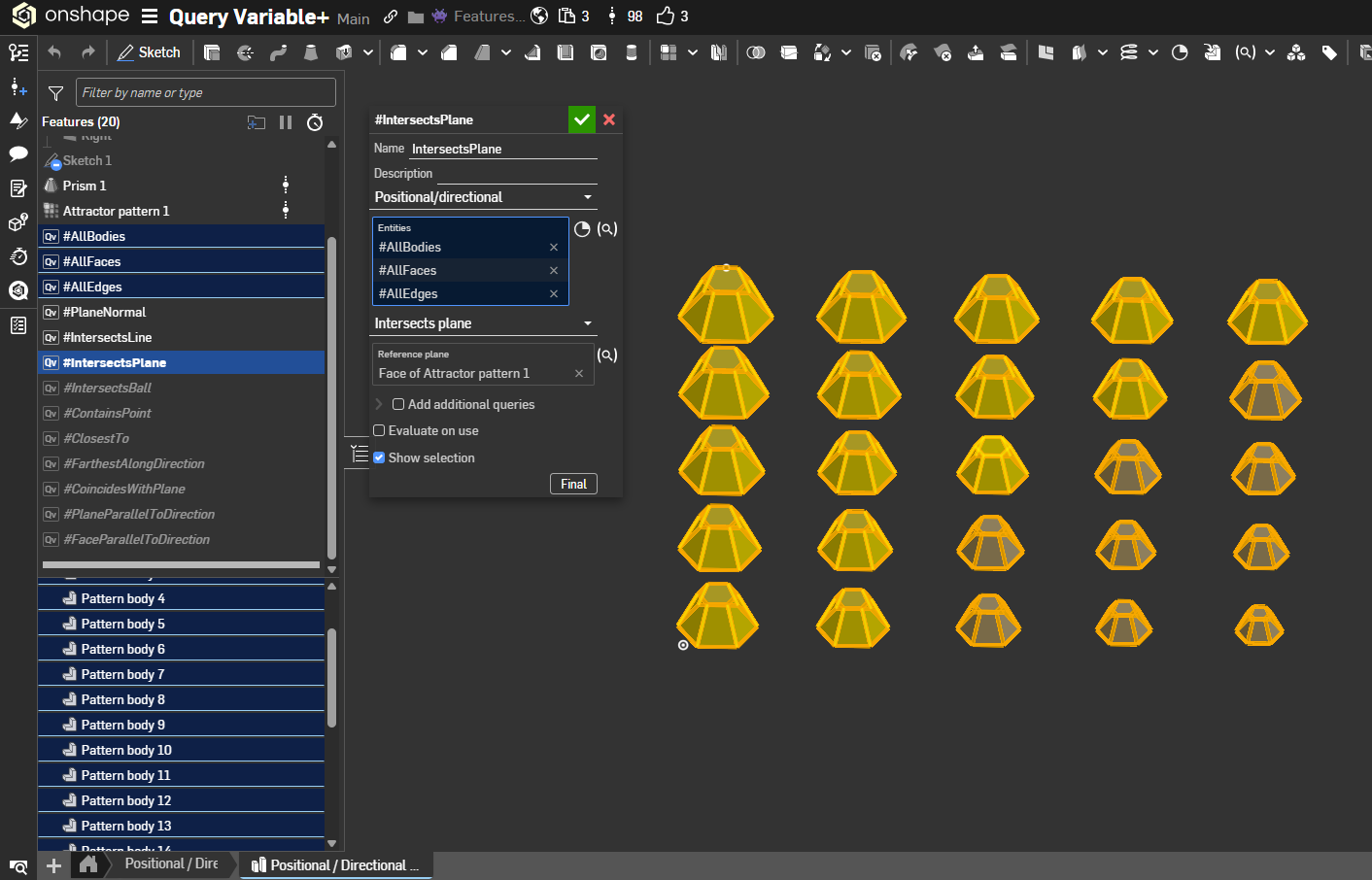

    Yeah yeah okay fine, that update was mid and I could do better. Here's 10 more query options for you all under the Positional / Directional query umbrella:
    • Plane Normal: Takes a reference plane face (positionalPlane) and filters the input entities (positionalEntities) to those with normals parallel to that plane via qParallelPlanes; returns a Query of the matching entities.
    • Intersects Line: Uses a selected linear edge (positionalLine) to keep entities intersecting that line through qIntersectsLine; outputs a Query of the intersecting entities.
    • Intersects Plane: Requires a planar face reference and applies qIntersectsPlane to find entities crossing that plane; returns a Query of intersecting entities.
    • Intersects Ball: Uses a reference vertex plus a radius to select entities within that sphere via qWithinRadius; emits a Query of entities inside or touching the ball.
    • Contains Point: With a reference vertex, applies qContainsPoint to find entities that include the point; outputs a Query of containing entities.
    • Closest To: Given a reference vertex, uses qClosestTo to pick the nearest entities to that point; returns a Query of the closest hits.
    • Farthest Along Direction: Accepts a direction reference (edge or direction-capable selection) and uses qFarthestAlong to keep entities farthest in that direction; results in a Query of those entities.
    • Coincides With Plane: Selects a reference plane and returns entities that lie on it via qCoincidesWithPlane; output is a Query of coincident entities.
    • Plane Parallel To Direction: Uses a direction reference and qPlanesParallelToDirection to keep planar entities whose normals align with that direction; produces a Query.
    • Face Parallel To Direction: Also direction-based; applies qFacesParallelToDirection to retain faces parallel to the given direction, returning a Query of those faces
