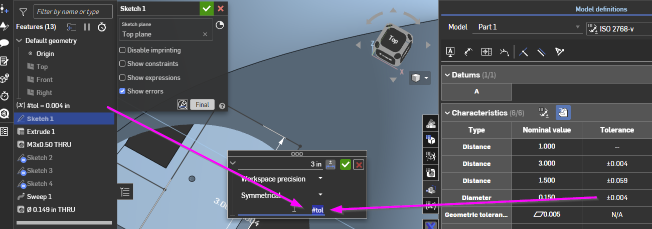

    I had a thought and decided to go and check and it turns out that you can in fact use variables in MBD dialogues, so you could automatically relate a clearance dimension (eg added with a "move face") and the MBD tolerances.
    For example make the clearance between two parts 2X the tolerance value.
    As far as getting the MBD info into drawings, the hole feature basically previews how that would work as the part studio tolerances have been brought into the 2D drawing environment for a while for these.
