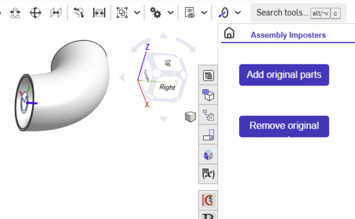

    @Derek_Van_Allen_BD If I understand what your asking, then yes, that is what we made it for.
    See the 🧰CADSharp Toolbox app for more info about 🕵️Assembly Imposters app and feature combo. It lets you dump an entire part studio into the assembly and it de-duplicates the parts. It does require you to tag the parts within the part studio beforehand. But this is easy if you use custom features built for it.
    There are currently two features that are set up for it: Assembly Imposters feature, and the Routing Curve+ feature. These are simply examples but you could use them and extend the functionality to any custom feature then use the Assembly Imposters sub app with them. The features mark the part studio parts as hide from bom and not revision managed, this way your original part reference is what is being used in the assembly.
    You can tag the part studio part with the original part URL using the imposters feature, for example a bunch of pvc elbows in a part studio pipe run, then when the entire part studio (All pipes from that pipe rout) is dumped into the assembly, you can run the imposter app and it will de-duplicate all parts that have been marked as "imposters", giving you a clean BOM with accurate qty's for each duplicate part.
