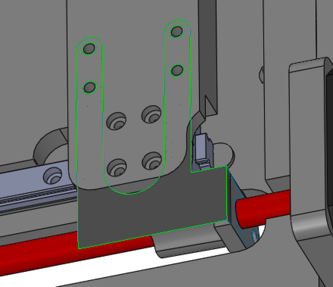

    A surface flatten tool which worked for compound curved surfaces would be even more awesome!
    @billy: Could you put more clarity and detail around your plea for "trimmed surface from sketch"?

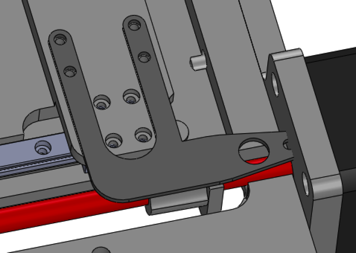

    @billy, That is pretty interesting and I can see how it would work for you.  A lot of sheet metal requires bending with an inside bend radius less than 1.5 * material thickness.  I think you have to be somewhere around 3 * thickness to have a neutral axis in the middle of the part.  This would be necessary for the flattening of the bent section, where the flattening radius would be in the middle of the thickness, as in your example.  With a true sheet metal function this bend allowance is easily handled with bend deductions or k-factors resulting in dead-on flat patterns.  Many bends are done with the inside bend radius less than the material thickness and a k-factor of less than .35.
    I agree the surfacing functions are needed in OS, but we will still need a set of true sheet metal capabilities.

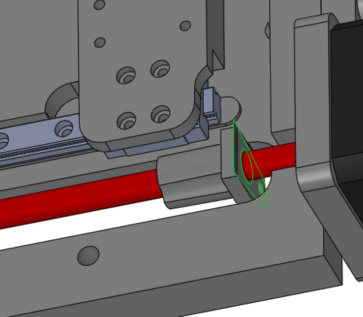

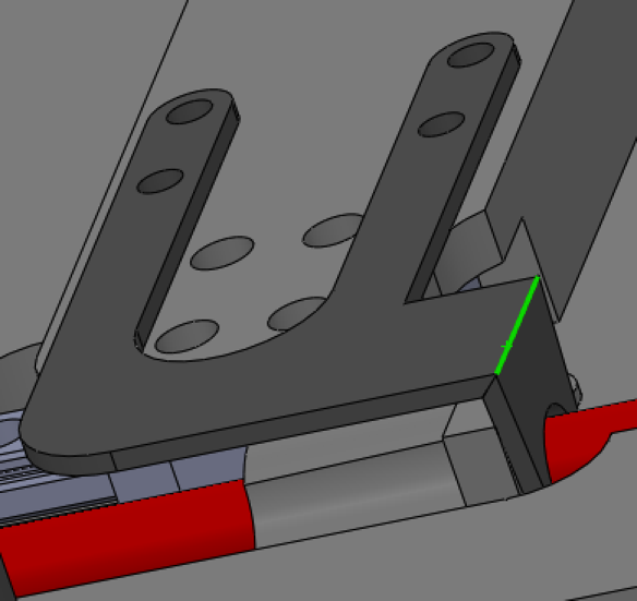

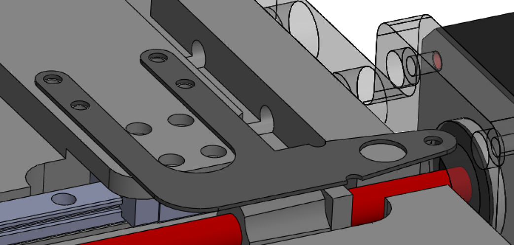

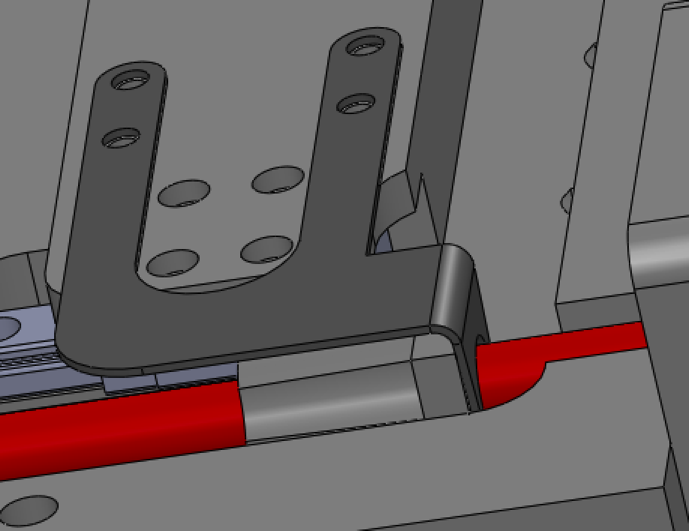

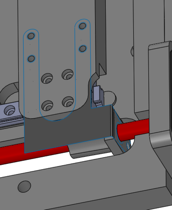

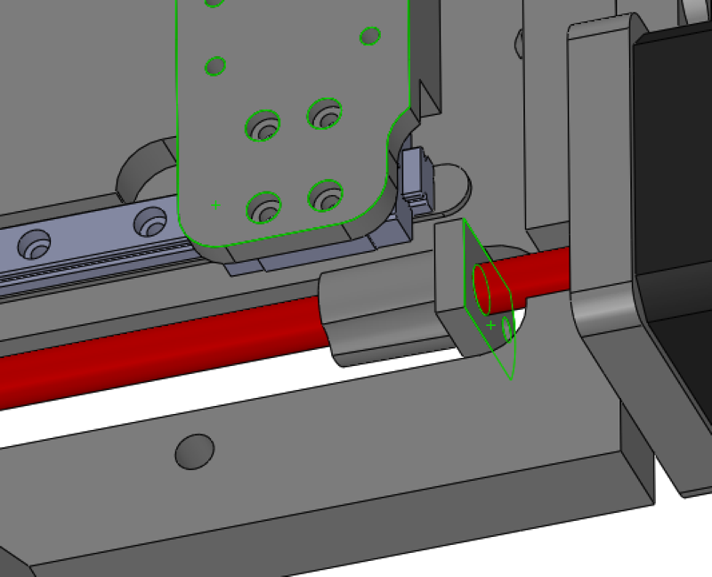

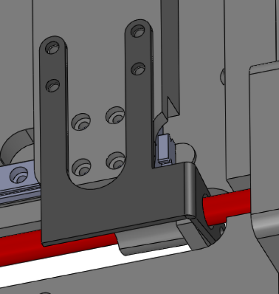

  • billy2billy2 Member, OS Professional, Mentor, Developers, User Group Leader Posts: 2,100 PRO
    Dennis you're absolutely right, it's better to use the unfold algorithm to add the fillets. I typically don't add the fillets:
    The convert sheet metal feature in SW added a larger radius:

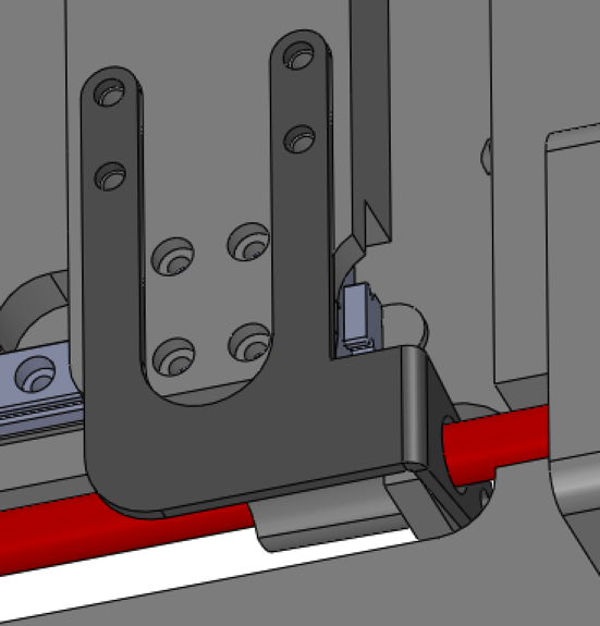

    We tried making this part out of aluminum which kept cracking in the corners so we switched to 316 SS. The part is much thinner now and has a tighter radius.
    We also need to add notches to show where the bend goes:

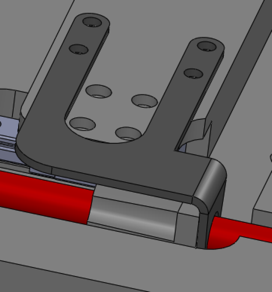

    So this is probably a more accurate part:
    The irony about all of this is that I fixed this layout to show you the updated bracket and how it's really made. I'm working on a local copy of the database and the master is located at the company on a NAS drive. I probably won't take the time to thread this back into the master layout. Everything I did will be deleted.
    If this was Onshape, I would have done all this work in the only, single, master database and the master layout would be in a better state. I think this illustrates the beauty of one database and one place to get things done.
