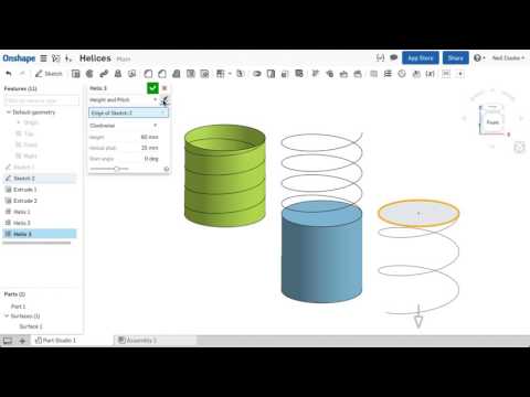

  2. IMPROVED Create a helix from a circular edge and hide all helix features - a further three options have been added to the helix feature to allow you to create a helix from a circular edge or sketch circle: Height and Turns, Height and Pitch, and Turns and Pitch. Also, when you have more than one helix in your Part Studio, you can now right click a helix feature and select: Hide, Hide other helices, Hide all helices, or Show, Show all helices.
    https://youtu.be/DGKKZ4xYEOo
