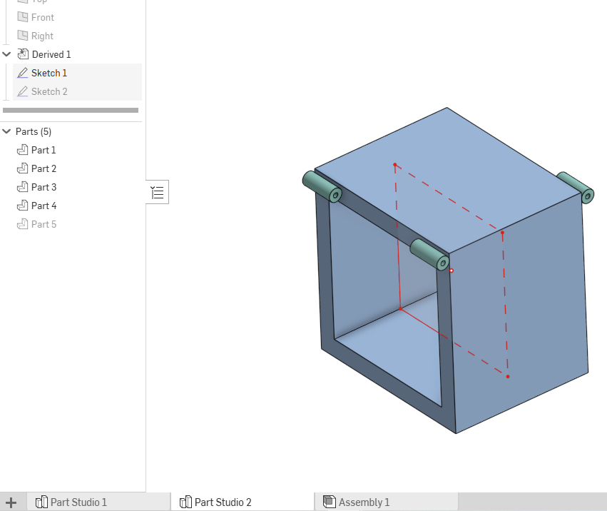

  • S1monS1mon Member Posts: 4,074 PRO
  • john_longphrejohn_longphre Member Posts: 13 PRO
    The inability to hide derived images is curious.  I can hide derived planes but not the imported reference images (e.g. a three-view drawing) that are used to make the master sketches...  It detracts from the utility of the derived feature.
    Or am I just not doing something correctly?  (clicking on the eyeball doesn't seem to hide any of the reference images, so I THINK I am doing it correctly).
    Derive features can now be expanded. If you do that you can turn visibility on and off for each sketch. If that doesn’t solve the issue, it sounds like a support question. And/or, perhaps you can share a public document?

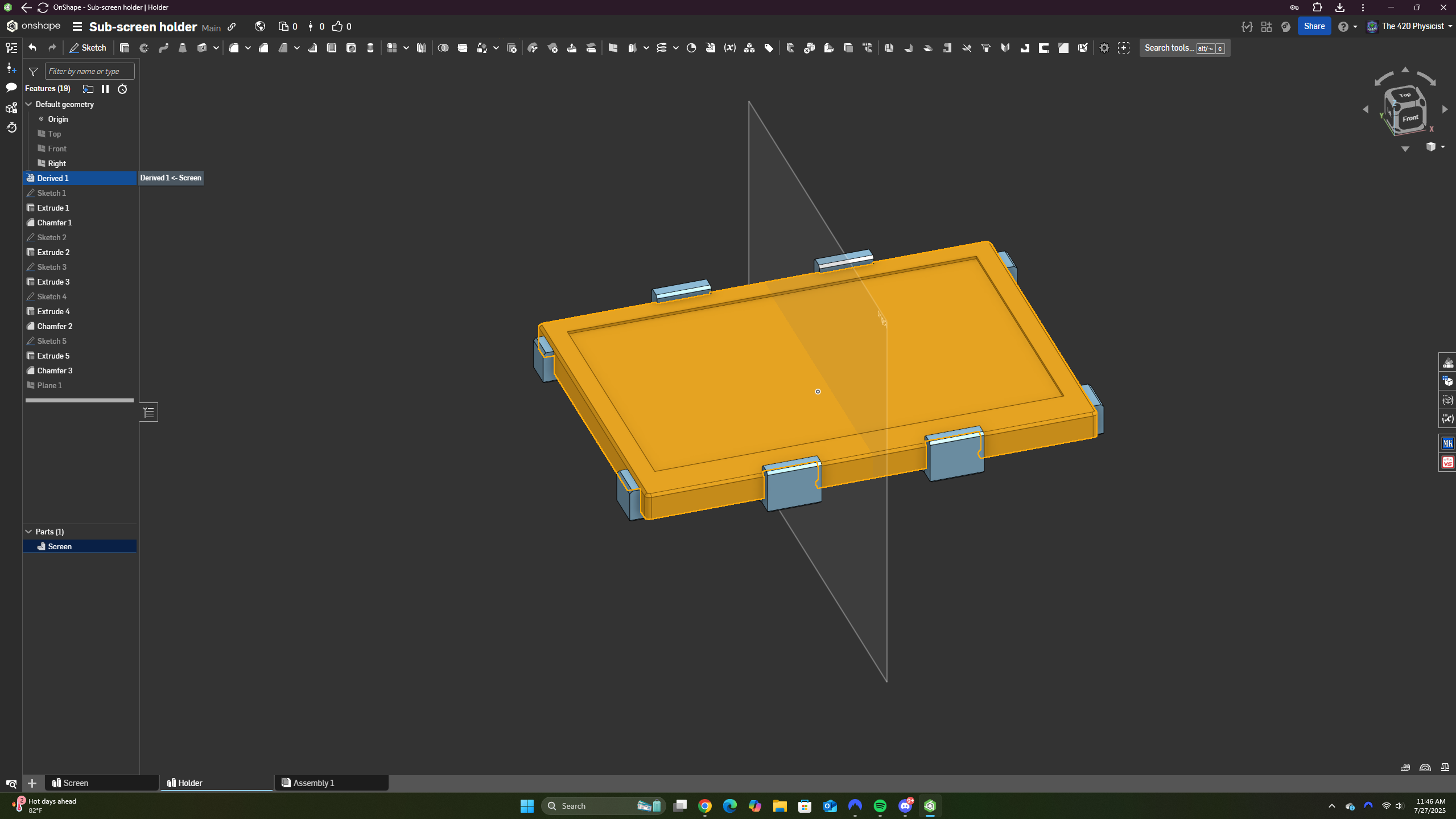

  • The_420_PhysicistThe_420_Physicist Member Posts: 2
    Apparently some things weren't fixed.. July 2025, and can't hide a derived part. Can't export separately. Part studio treats and one hunk of crap! :(
    edited July 2025
    The_420_Physicist
    Your document hasn't been updated lately.
    Trash the document and then recover from trash. It will put up a dialog about updating next time you open. Once updated it will behave as S1mon says.
