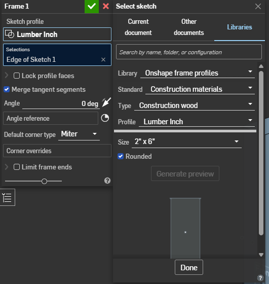

    Sneaky shadow update I noticed, there are more frame profiles included in the Onshape Libraries now like construction lumber:
  • EvanReeseEvanReese Member, Mentor Posts: 2,564 PRO
  • S1monS1mon Member Posts: 3,601 PRO
    I stumbled on the Lumber profiles last Friday, but I think it was before the What's New was posted, so I wasn't sure.
    Looking at the change log, I don't see anything about the Lumber profiles, but I do see this curious item:
    "Improve Bezier feature to be more consistent with the Spline feature."
    Anyone know what that means?
