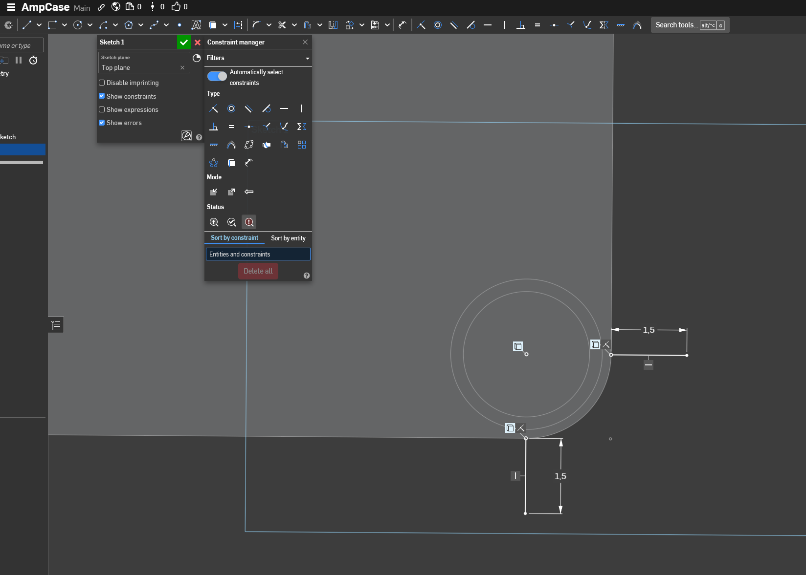

So, I want to put an arc in my sketch. I have a center point, I have a point where I want to start this ark and where I want to end it. So I use the center point arc tool and watch how half of my sketch get's lid in red, like so:
But when I do literally the same thing, but instead of ending ark in one of those two points, I continue the arc just a little bit further - everything is ok, sketch resolving correctly:
And that would be fine except that now I'm getting a loose end in my sketch. Which makes me a bit annoyed.
As far as I can see, it does not matter which direction the arc is made - the result is always the same. It precisely passes through both point 1 and point 2, but everything resolves correctly only when I get it past the ending point.

  • NeilCookeNeilCooke Moderator, Onshape Employees Posts: 5,970 image
    Millimetres are also SI units. It's not surprising that your sketch is having difficulties solving - why are there so many short, unconstrained lines? The general rule of thumb is to keep sketches simple with no more than 20 entities or so.

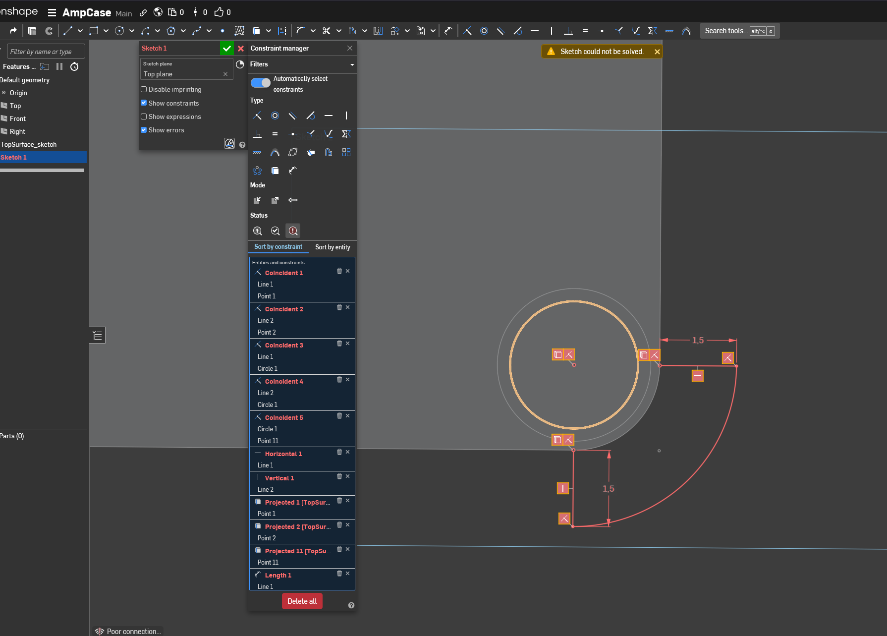

    Ok, so I have a new project with a very similar problem.
    As you said, I keep sketches simple with no more than 20 entities or so. At this point, I am not trying to copy any preexisting geometry from imported parts. There are no short unconstrained lines. Matter of fact, there are only 2 lines and three points. Points are projected from another sketch.
    When I try to create an ark, I get this:
    What am I doing wrong now?
    https://cad.onshape.com/documents/69e7729efc7e85734969bb28/w/68aefed83c649b34e9d41bf0/e/2857a9717d932c5277e766f0?renderMode=0&uiState=6985101c2414e16ef38afc85
    It's overconstrained - delete one of the 1.5 dims

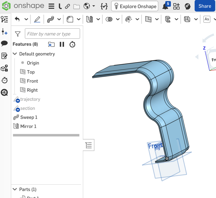

    For your main arc shape in your original question, you could have had the main sketch have a single arc, instead of 4 offset arcs. Then use thin extrude to make your shape. Then use thicken (new) to do the additional ribbing, and move face of those thickens. Then union everything at the end. Much simpler and easier.
    Actually, scratch all that. Looking again, sweep is probably the way to build your part. A single line for the path, and another sketch of the cross section.

    How can center arc work with 3 points from a geometry standpoint? (if the 3 points are constrained). The center point and the first point will define the radius. The third point if it was arbitrarily placed into space, will not be on the same radius, and the arc won't touch it.

    Here is your main shape in 4 features, using sweep.
