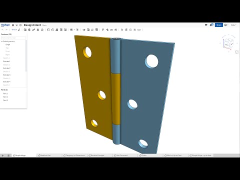

    Found this video very helpful....
    https://www.youtube.com/watch?v=vRw3pD6bkks
