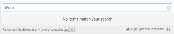

    I searched for the Wrap feature but can not find it.
    Is Wrap only for Pro's?

  • emagdalenaC2iemagdalenaC2i Member, Developers, Channel partner Posts: 864 ✭✭✭✭✭
    @Henk_de_V No it should be there for all users... but there is not
    The code is in the std document https://cad.onshape.com/documents/12312312345abcabcabcdeff/w/a855e4161c814f2e9ab3698a/e/5e2ac00ef43da299ccb2ff00
    I believe that someone missed to ad that icon  :o
    @lana I have just created a new document but the icon isn't there
    Un saludo,
    Ahh No, it is there
    Un saludo,
  • lanalana Onshape Employees Posts: 761 image
    It is there for me. Might be hard to find - under Transform:
  • Henk_de_VlaamHenk_de_Vlaam Member, Developers Posts: 267 ✭✭✭
    edited August 2019
    OK, I see it now.

  • john_mcclaryjohn_mcclary Member, Developers Posts: 4,050 PRO
    You have to add it to the toolbar, it is off by default it looks.. Probably due to having a custom toolbar before it was added
