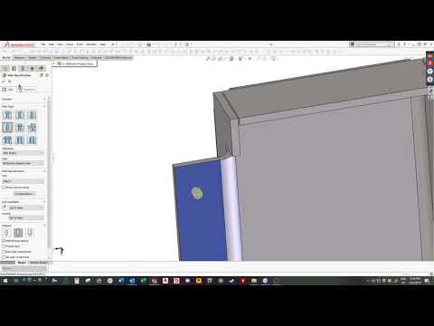

  • john_mcclaryjohn_mcclary Member, Developers Posts: 4,051 PRO
    See what I mean, I was done typing when it showed I was entering 19..
    at least it keeps every key press, even when I open notepad :)
