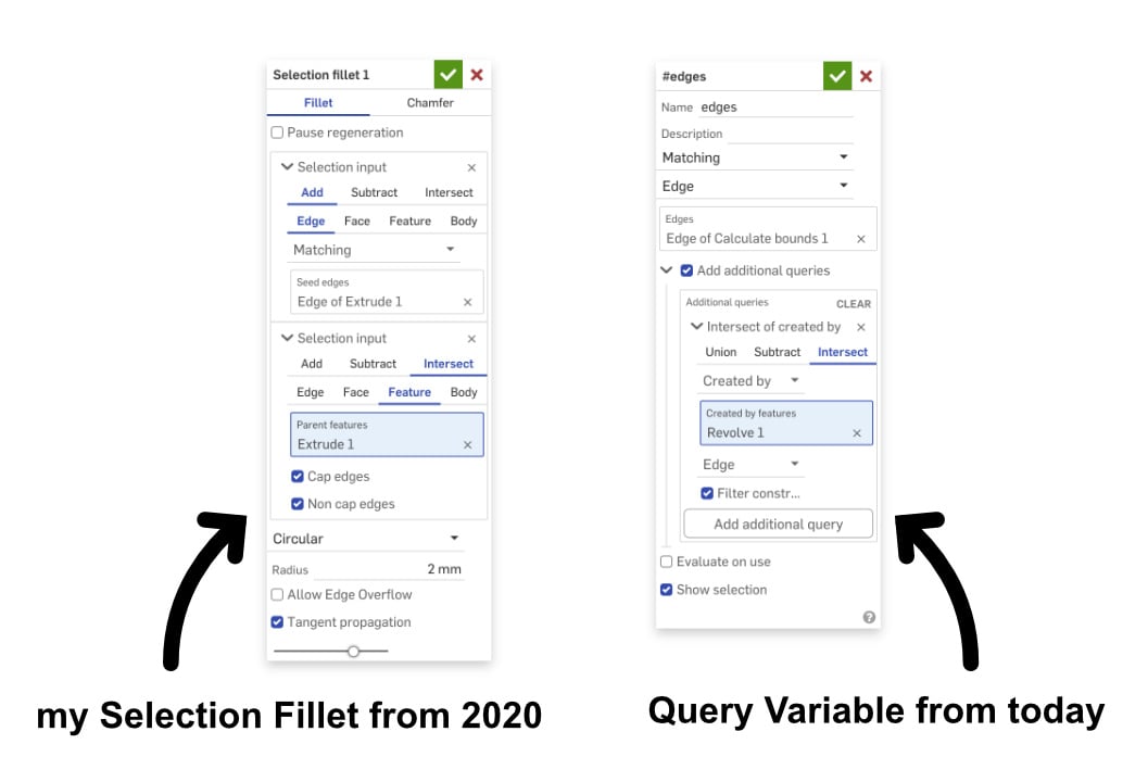

Selection Fillet takes a lot of inspiration from the "Create selection" tool already built into Onshape. The idea is to add that selection logic (and more) and make that selection logic update with the model. I'm able to make my models all really robust to change with the exception of tiny finishing fillets I add (usually for injection molding). This tool is trying to solve that issue. I recorded a quick video showing how it works. You can watch that demo here and add the feature to your toolbar here. Let me know what you think!

    One small request... is it possible to name the feature "selection chamfer 1" instead of "selection fillet 1" when I use the chamfer option?
    Overall this is still one of the most essential custom features. I would be so happy if this kind of logic was built in...
    https://forum.onshape.com/discussion/18616/implement-selection-filters-like-evan-reeses-selection-fillet-or-selection-draft-everywhere
    It's possible, but a lot less straightforward than leaving it. I'd need to use editing logic, and I don't think they'd auto-number anymore (i.e. "Selection fillet 1" and the next one "Selection fillet 2")

    Hey @tim_o and @peter_van_westen sorry I missed your messages. I think you may have mentioned my old username so I didn't get notified. I came here today to declare this feature deprecated with the new release of Query Variables! Very happy to see the implementation of that one. I won't have to totally re-work my brain to use it.
